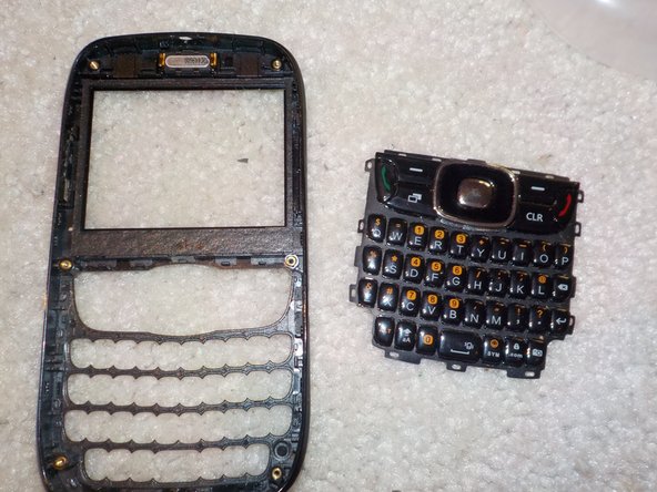

  3. ZTE Z432  Teardown, Front panel: crwdns2935265:03crwdnd2935265:01crwdnd2935265:02crwdne2935265:0 ZTE Z432  Teardown, Front panel: crwdns2935265:03crwdnd2935265:02crwdnd2935265:02crwdne2935265:0
    • Remove the 7 P0 phillips screws under the rear cover. Then, some careful prying is required to seperate the back and front panels. This can be achieved with a large plastic opening tool. The front panel contains the keypad and power/volume buttons, which can be removed.
