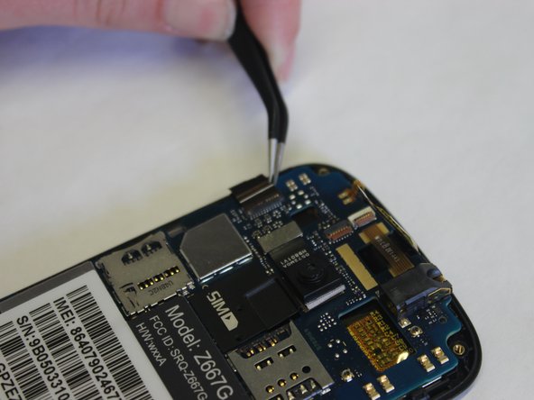

  7. ZTE Whirl 2 Speaker Replacement: crwdns2935265:07crwdnd2935265:01crwdnd2935265:01crwdne2935265:0
    • Use a tweezers to lift the lock from the ZIF connector above the camera. Pull the ribbon from the connector.
    • The ribbon is connected by a lock. Flip the lock up to unlatch the ribbon with a set of tweezers.
