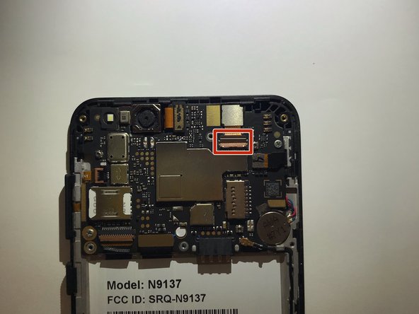

  4. ZTE Tempo X Front Facing Camera Replacement: crwdns2935265:04crwdnd2935265:01crwdnd2935265:03crwdne2935265:0 ZTE Tempo X Front Facing Camera Replacement: crwdns2935265:04crwdnd2935265:02crwdnd2935265:03crwdne2935265:0 ZTE Tempo X Front Facing Camera Replacement: crwdns2935265:04crwdnd2935265:03crwdnd2935265:03crwdne2935265:0
    • Using the spudger, detach the brown flap by flipping it towards you.

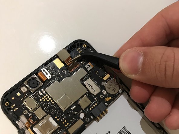

    • With a fine pair of tweezers, pull the front facing camera from the phone.
