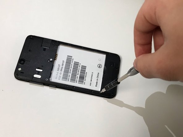

  3. ZTE Tempo X Charging/Aux Board Replacement, Charging/Aux Board: crwdns2935265:03crwdnd2935265:01crwdnd2935265:02crwdne2935265:0 ZTE Tempo X Charging/Aux Board Replacement, Charging/Aux Board: crwdns2935265:03crwdnd2935265:02crwdnd2935265:02crwdne2935265:0
    • Remove the sixteen 3mm screws using the Phillips #000 screwdriver.

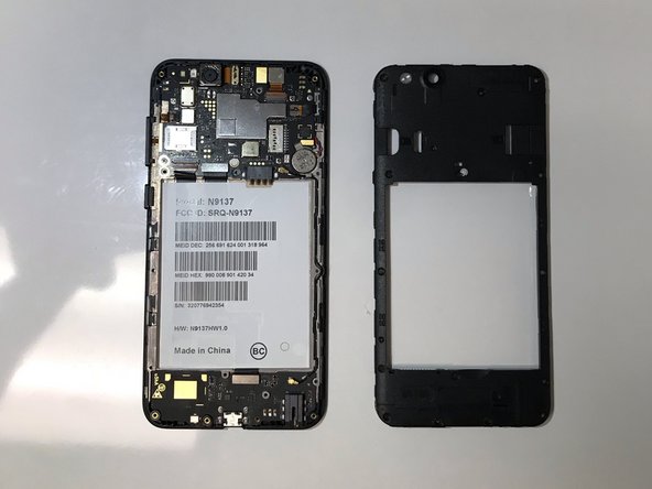

  4. ZTE Tempo X Charging/Aux Board Replacement: crwdns2935265:04crwdnd2935265:01crwdnd2935265:02crwdne2935265:0 ZTE Tempo X Charging/Aux Board Replacement: crwdns2935265:04crwdnd2935265:02crwdnd2935265:02crwdne2935265:0
    • Take off the second back cover, lifting from the bottom of the device to the top.

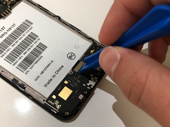

  5. ZTE Tempo X Charging/Aux Board Replacement: crwdns2935265:05crwdnd2935265:01crwdnd2935265:03crwdne2935265:0 ZTE Tempo X Charging/Aux Board Replacement: crwdns2935265:05crwdnd2935265:02crwdnd2935265:03crwdne2935265:0 ZTE Tempo X Charging/Aux Board Replacement: crwdns2935265:05crwdnd2935265:03crwdnd2935265:03crwdne2935265:0
    • Using a spudger, unclip the board from the phone at the places highlighted.

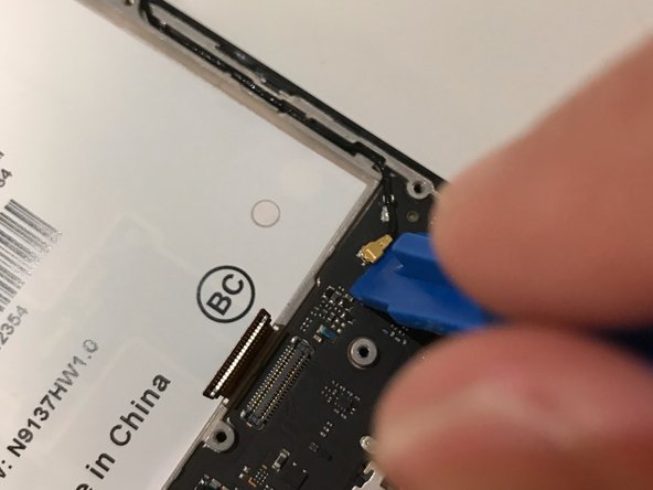

  6. ZTE Tempo X Charging/Aux Board Replacement: crwdns2935265:06crwdnd2935265:01crwdnd2935265:03crwdne2935265:0 ZTE Tempo X Charging/Aux Board Replacement: crwdns2935265:06crwdnd2935265:02crwdnd2935265:03crwdne2935265:0 ZTE Tempo X Charging/Aux Board Replacement: crwdns2935265:06crwdnd2935265:03crwdnd2935265:03crwdne2935265:0
    • Use the spudger to remove the board from the phone.
    • The board is held by glue so there will be resistance when detaching it from the phone.
