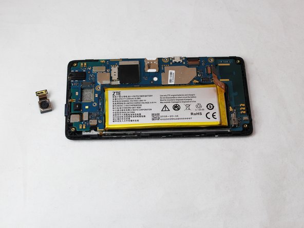

    • Pry open the back case to get to the back cover.
    • Remove eight 5mm screws with a PH0 screw.
    • Pry open the back cover with a plastic opening tool.
    • Slide the plastic opening tool alongside the side seam twisting your hand forcefully to open the back cover.
    • Note: Pry open by finding an edge and forcing it open with the plastic opening tool.
  2. ZTE Tempo Rear Camera Replacement: crwdns2935265:02crwdnd2935265:01crwdnd2935265:02crwdne2935265:0 ZTE Tempo Rear Camera Replacement: crwdns2935265:02crwdnd2935265:02crwdnd2935265:02crwdne2935265:0
    • Use a plastic opening tool to lift the press-fit connector up and disconnect the battery ribbon cable.
  3. ZTE Tempo Rear Camera Replacement: crwdns2935265:03crwdnd2935265:01crwdnd2935265:02crwdne2935265:0 ZTE Tempo Rear Camera Replacement: crwdns2935265:03crwdnd2935265:02crwdnd2935265:02crwdne2935265:0
    • Use a plastic opening tool to lift the press-fit connector up and disconnect the rear camera ribbon cable.
    • Lift the rear camera out of the phone.
