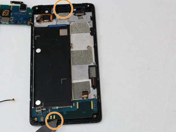

  3. ZTE Tempo Front Screen Assembly Replacement, Front Screen Assembly: crwdns2935265:03crwdnd2935265:01crwdnd2935265:03crwdne2935265:0 ZTE Tempo Front Screen Assembly Replacement, Front Screen Assembly: crwdns2935265:03crwdnd2935265:02crwdnd2935265:03crwdne2935265:0 ZTE Tempo Front Screen Assembly Replacement, Front Screen Assembly: crwdns2935265:03crwdnd2935265:03crwdnd2935265:03crwdne2935265:0
    • Use the plastic opening tool to unplug the three connectors.
  4. ZTE Tempo Front Screen Assembly Replacement: crwdns2935265:04crwdnd2935265:01crwdnd2935265:01crwdne2935265:0
    • Use the plastic opening tool to push up on the wire to remove it completely.
  5. ZTE Tempo Front Screen Assembly Replacement: crwdns2935265:05crwdnd2935265:01crwdnd2935265:02crwdne2935265:0 ZTE Tempo Front Screen Assembly Replacement: crwdns2935265:05crwdnd2935265:02crwdnd2935265:02crwdne2935265:0
    • Insert and slide the plastic opening tool alongside the seam, gently wiggling the opening tool to open and remove the motherboard.
  6. ZTE Tempo Front Screen Assembly Replacement: crwdns2935265:06crwdnd2935265:01crwdnd2935265:03crwdne2935265:0 ZTE Tempo Front Screen Assembly Replacement: crwdns2935265:06crwdnd2935265:02crwdnd2935265:03crwdne2935265:0 ZTE Tempo Front Screen Assembly Replacement: crwdns2935265:06crwdnd2935265:03crwdnd2935265:03crwdne2935265:0
    • Use the metal spudger to push up to remove the volume control.
    • Use the tweezers to remove the front speaker and bottom controller.
