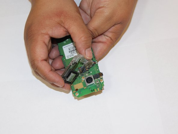

  9. ZTE Telstra T95 Headphone Jack Replacement, Headphone Jack: crwdns2935265:09crwdnd2935265:01crwdnd2935265:01crwdne2935265:0
    • Remove the back casing by taking the motherboard and back casing and pulling them apart.

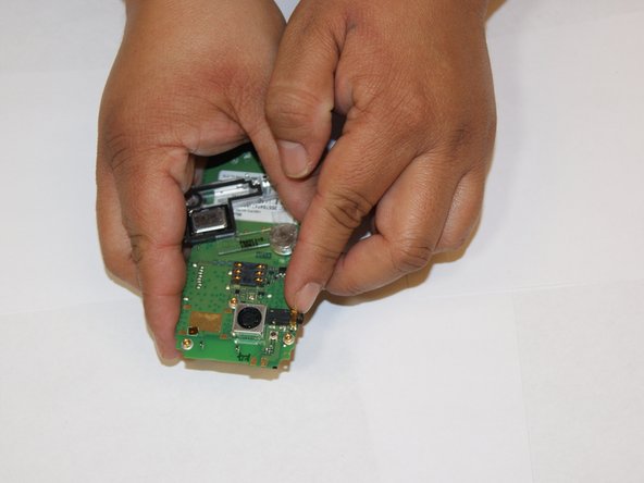

  10. ZTE Telstra T95 Headphone Jack Replacement: crwdns2935265:010crwdnd2935265:01crwdnd2935265:02crwdne2935265:0 ZTE Telstra T95 Headphone Jack Replacement: crwdns2935265:010crwdnd2935265:02crwdnd2935265:02crwdne2935265:0
    • Using a small phillips #00 screw driver remove the three screws on the clear cover.
    • Screw sizes are 1.15mm in width and 1.51mm in length.
  11. ZTE Telstra T95 Headphone Jack Replacement: crwdns2935265:011crwdnd2935265:01crwdnd2935265:02crwdne2935265:0 ZTE Telstra T95 Headphone Jack Replacement: crwdns2935265:011crwdnd2935265:02crwdnd2935265:02crwdne2935265:0
    • The headphone jack is a square piece at the bottom center of the phone that is sticking out.
    • If it is loose simply remove it.
    • If it is still attached you must remove the headphone jack using the heat pen on your soldering station on top of the headphone jack until it becomes loose.
    • Gently remove the headphone jack using tweezers.
    • At this point you can solder the new headphone jack.
