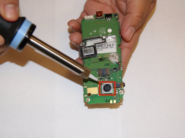

  9. ZTE Telstra T95 Front/Rear Facing Camera Replacement, Front/Rear Facing Camera: crwdns2935265:09crwdnd2935265:01crwdnd2935265:01crwdne2935265:0
    • Remove the back casing by taking the motherboard and back casing and pulling them apart.
  10. ZTE Telstra T95 Front/Rear Facing Camera Replacement: crwdns2935265:010crwdnd2935265:01crwdnd2935265:01crwdne2935265:0
    • Using a small phillips #00 screw driver remove the three screws on the clear cover.
    • Screw sizes are 1.15mm in width and 1.51mm in length.
  11. ZTE Telstra T95 Front/Rear Facing Camera Replacement: crwdns2935265:011crwdnd2935265:01crwdnd2935265:02crwdne2935265:0 ZTE Telstra T95 Front/Rear Facing Camera Replacement: crwdns2935265:011crwdnd2935265:02crwdnd2935265:02crwdne2935265:0
    • The back camera is a circular piece at the top center of the phone that is sticking out.
    • The from camera is a circular piece at the top right side of the phone that is sticking out.
    • identify which camera you wish to replace, If it is still attached you must remove the headphone jack using the heat pen on your soldering station on top of the headphone jack until it becomes loose.
    • Gently remove the camera using tweezers.
    • At this point you can solder the new camera.
