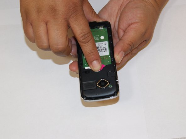

  5. ZTE Telstra T95 Charging Port Replacement: crwdns2935265:05crwdnd2935265:01crwdnd2935265:02crwdne2935265:0 ZTE Telstra T95 Charging Port Replacement: crwdns2935265:05crwdnd2935265:02crwdnd2935265:02crwdne2935265:0
    • Remove the SIM card by placing your index finger over it and sliding it out.
    • When you are ready to re-insert the SIM card make sure the pink side facing up.
