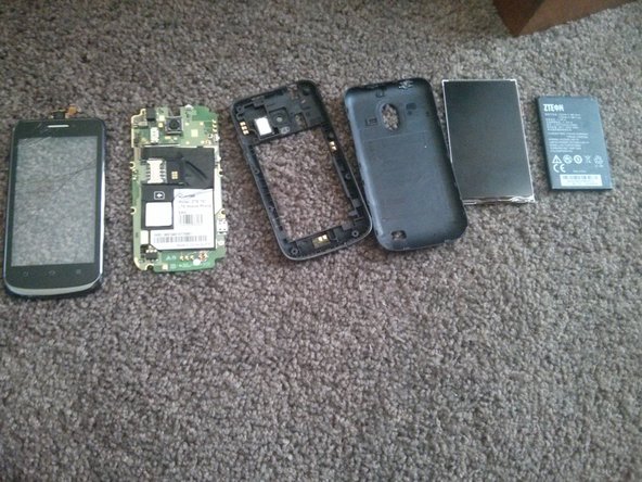

  1. ZTE T81 Teardown, Remove the back cover, SIM card, battery and SD card: crwdns2935265:01crwdnd2935265:01crwdnd2935265:01crwdne2935265:0
    • Remove the back cover, SIM card, battery and SD card.

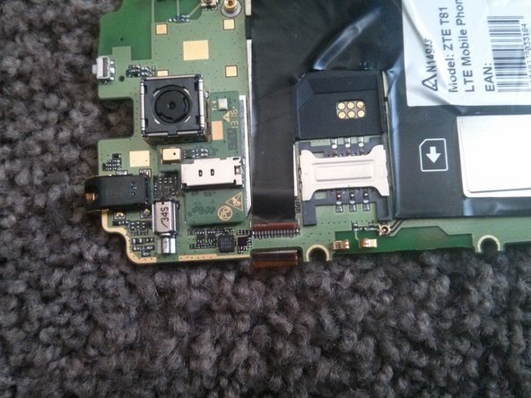

  2. ZTE T81 Teardown, Remove the screws: crwdns2935265:02crwdnd2935265:01crwdnd2935265:02crwdne2935265:0 ZTE T81 Teardown, Remove the screws: crwdns2935265:02crwdnd2935265:02crwdnd2935265:02crwdne2935265:0
    • Remove the 9 screws under the back cover. The top left screw is covered by a white "warranty void" sticker.

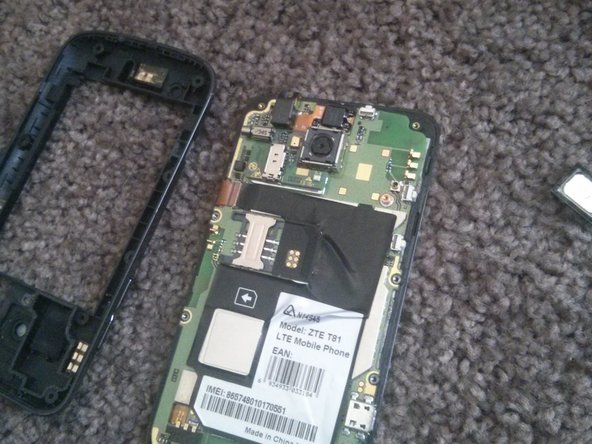

  3. ZTE T81 Teardown, Separate the frame from the mainboard: crwdns2935265:03crwdnd2935265:01crwdnd2935265:02crwdne2935265:0 ZTE T81 Teardown, Separate the frame from the mainboard: crwdns2935265:03crwdnd2935265:02crwdnd2935265:02crwdne2935265:0
    • Separate the frame from the mainboard
    • Pry apart the frame with the battery holder and camera housing from the mainboard of the phone.

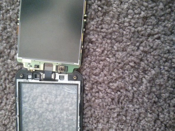

  4. ZTE T81 Teardown, Remove the front glass.: crwdns2935265:05crwdnd2935265:01crwdnd2935265:02crwdne2935265:0 ZTE T81 Teardown, Remove the front glass.: crwdns2935265:05crwdnd2935265:02crwdnd2935265:02crwdne2935265:0
    • Remove the digitizer cable and separate the digitizer/front glass from the rest of the phone.

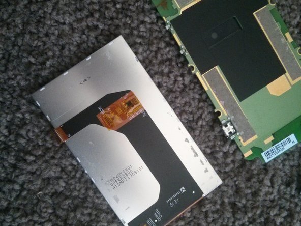

  5. ZTE T81 Teardown, Remove the LCD screen: crwdns2935265:06crwdnd2935265:01crwdnd2935265:03crwdne2935265:0 ZTE T81 Teardown, Remove the LCD screen: crwdns2935265:06crwdnd2935265:02crwdnd2935265:03crwdne2935265:0 ZTE T81 Teardown, Remove the LCD screen: crwdns2935265:06crwdnd2935265:03crwdnd2935265:03crwdne2935265:0
    • Unplug the LCD screen from the mainboard and carefully peel the display off the mainboard. It is only stuck on.
