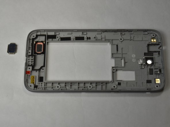

    • Use the Hakko 5B SA curved tweezers to dig under the top slit of the speaker and pull upwards.
  6. ZTE Prestige 2 Speaker Replacement: crwdns2935265:06crwdnd2935265:01crwdnd2935265:02crwdne2935265:0 ZTE Prestige 2 Speaker Replacement: crwdns2935265:06crwdnd2935265:02crwdnd2935265:02crwdne2935265:0
    • Use the curved tweezers to grab onto one of the corners of the speaker and pull upwards and lift out.
