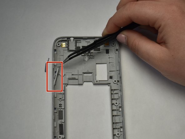

  5. ZTE Prestige 2 Power and Volume Buttons Replacement, Power and Volume Buttons: crwdns2935265:05crwdnd2935265:01crwdnd2935265:02crwdne2935265:0 ZTE Prestige 2 Power and Volume Buttons Replacement, Power and Volume Buttons: crwdns2935265:05crwdnd2935265:02crwdnd2935265:02crwdne2935265:0
    • Use the curved tweezers to pull upwards and out on the the thin plastic attached on both sides of the power button and volume buttons. This process should allow the buttons to pop right out.
