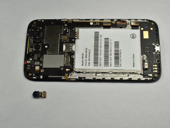

  5. ZTE Prestige 2 Front-Facing Camera Replacement, Front-Facing Camera: crwdns2935265:05crwdnd2935265:01crwdnd2935265:02crwdne2935265:0 ZTE Prestige 2 Front-Facing Camera Replacement, Front-Facing Camera: crwdns2935265:05crwdnd2935265:02crwdnd2935265:02crwdne2935265:0
    • Use the curved tweezers to lift up the press fit camera connector.
    • The front facing camera is located directly to the left of the rear facing camera.
    • Lift out the front facing camera.
