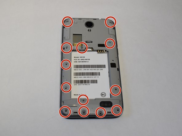

    • Use a Phillips #00 screwdriver to unscrew all 12 of the 3 mm Phillips screws located along the edges of the device’s back panel, as well as the blue 3mm Phillips screw labeled “ZTE” located towards the top right.

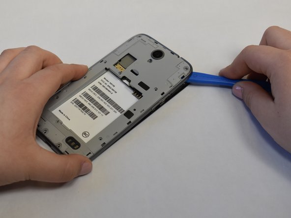

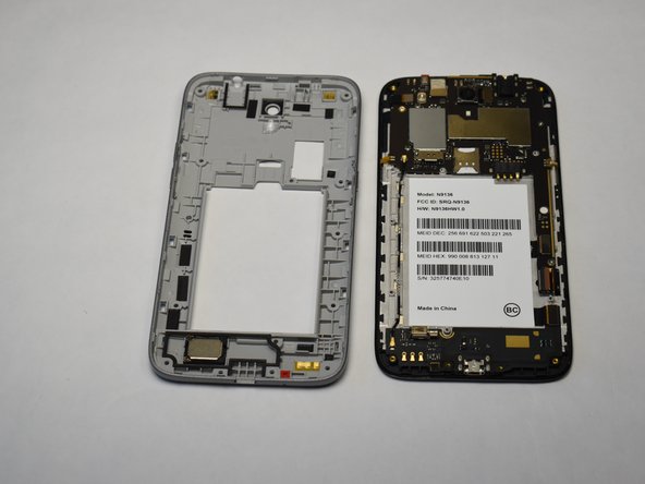

    • Then use the iFixit opening tool and wedge it under the grey back panel and pop it off.
    • There will be a lot of resistance, apply adequate pressure.
