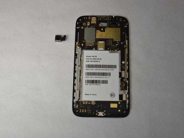

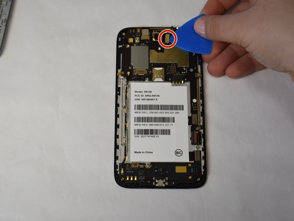

    1. ZTE Prestige 2 Back Camera Replacement, Back Camera: crwdns2935265:05crwdnd2935265:01crwdnd2935265:03crwdne2935265:0 ZTE Prestige 2 Back Camera Replacement, Back Camera: crwdns2935265:05crwdnd2935265:02crwdnd2935265:03crwdne2935265:0 ZTE Prestige 2 Back Camera Replacement, Back Camera: crwdns2935265:05crwdnd2935265:03crwdnd2935265:03crwdne2935265:0
      • Use the iFixit opening pick and wedge it under the press fit connector beside the camera located at the top center of the device to pop it off.
      • Remove the camera.
      • The camera cable near the press fit connector is delicate, ripping it will cause permanent damage.
      • The base of the camera may be glued down which may lead to accidental ripping during removal. Use the flat end of a metal spudger to pry it up if necessary.
