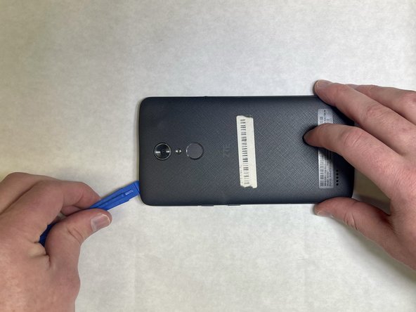

    • To break up any adhesive that connects the back plastic piece to the phone, apply the iOpener to the back of the phone. For instructions on how to use the iOpener please follow this guide.
    • On our phone there was adhesive on the top of the phone backing, so we specifically heated this area.
    • Do not heat the phone too much in one area - it may warp the plastic backing.
  3. ZTE Max XL Rear-Facing Camera Replacement: crwdns2935265:03crwdnd2935265:01crwdnd2935265:03crwdne2935265:0 ZTE Max XL Rear-Facing Camera Replacement: crwdns2935265:03crwdnd2935265:02crwdnd2935265:03crwdne2935265:0 ZTE Max XL Rear-Facing Camera Replacement: crwdns2935265:03crwdnd2935265:03crwdnd2935265:03crwdne2935265:0

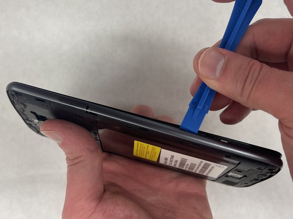

    • Starting at one corner, wedge a plastic opening pick or tool underneath the plastic backing to start undoing the tabs that connect the backing to the phone.
    • There are 3 tabs on top and bottom and 6 on each side.

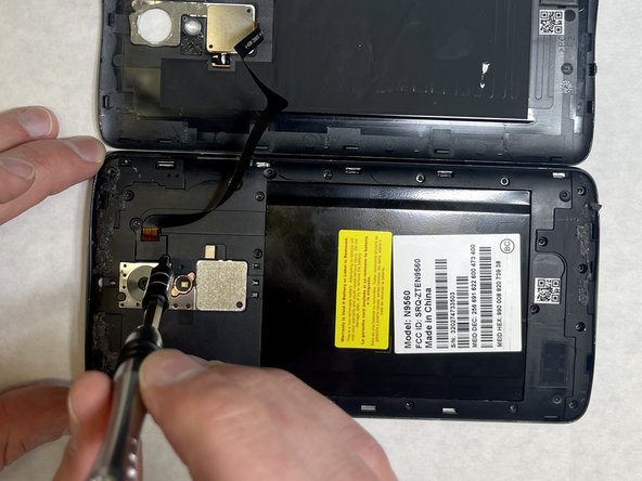

    • Remove the two 3.4 mm JIS #00 screws that hold the cable in place—one may be under a lock sticker.
  5. ZTE Max XL Rear-Facing Camera Replacement: crwdns2935265:05crwdnd2935265:01crwdnd2935265:01crwdne2935265:0
    • Use a nylon spudger to lift the press-fit connector and free the ribbon cable from the main part of the phone.

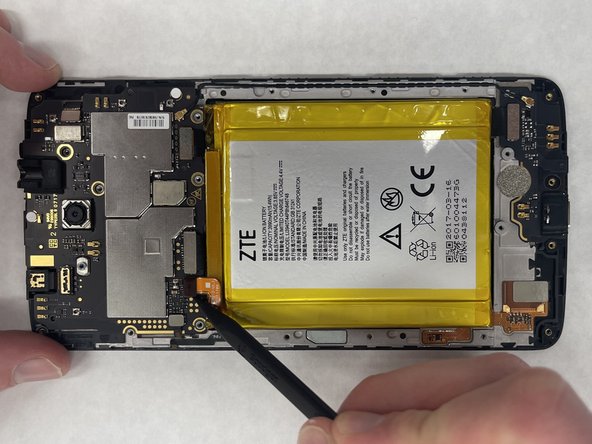

    • Use a nylon spudger to carefully lift the 6 press-fit connections free from the motherboard.
  9. ZTE Max XL Rear-Facing Camera Replacement: crwdns2935265:09crwdnd2935265:01crwdnd2935265:02crwdne2935265:0 ZTE Max XL Rear-Facing Camera Replacement: crwdns2935265:09crwdnd2935265:02crwdnd2935265:02crwdne2935265:0

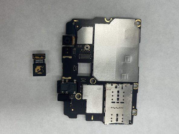

    • Use a nylon spudger to carefully lift the camera ribbon cable's press-fit connector free from the motherboard.
    • With the metal connector detached, the rear-facing camera is disconnected from the phone and can be replaced.
