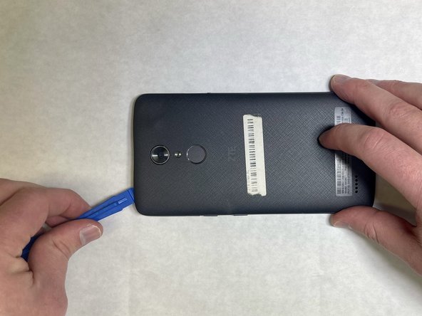

  2. ZTE Max XL Motherboard Replacement: crwdns2935265:02crwdnd2935265:01crwdnd2935265:01crwdne2935265:0
    • Apply the iOpener to the back of the phone. For instructions on how to use the iOpener, use this guide.
    • On our phone there was adhesive on the top and bottom of the phone backing, so we specifically heated these areas.
    • Do not heat the phone too much in one area - it may warp the plastic backing.

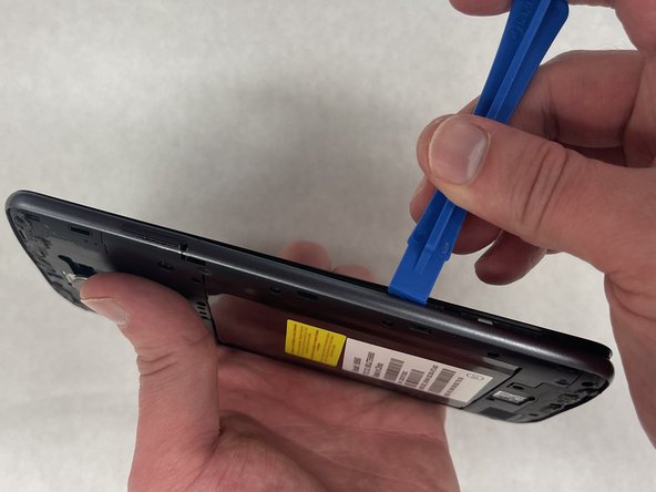

  3. ZTE Max XL Motherboard Replacement: crwdns2935265:03crwdnd2935265:01crwdnd2935265:03crwdne2935265:0 ZTE Max XL Motherboard Replacement: crwdns2935265:03crwdnd2935265:02crwdnd2935265:03crwdne2935265:0 ZTE Max XL Motherboard Replacement: crwdns2935265:03crwdnd2935265:03crwdnd2935265:03crwdne2935265:0
    • Starting at one corner, wedge a plastic opening pick or tool underneath the plastic backing to start undoing the tabs that connect the backing to the phone.
    • There are 3 tabs on top and bottom and 6 on each side.

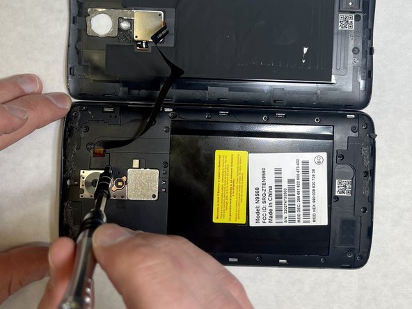

  4. ZTE Max XL Motherboard Replacement: crwdns2935265:04crwdnd2935265:01crwdnd2935265:02crwdne2935265:0 ZTE Max XL Motherboard Replacement: crwdns2935265:04crwdnd2935265:02crwdnd2935265:02crwdne2935265:0
    • Remove the two 3.4 mm JIS #00 screws that hold the cable in place—one may be under a lock sticker.
  5. ZTE Max XL Motherboard Replacement: crwdns2935265:05crwdnd2935265:01crwdnd2935265:01crwdne2935265:0
    • Use a nylon spudger to lift the press-fit connector and free the ribbon cable from the main part of the phone.

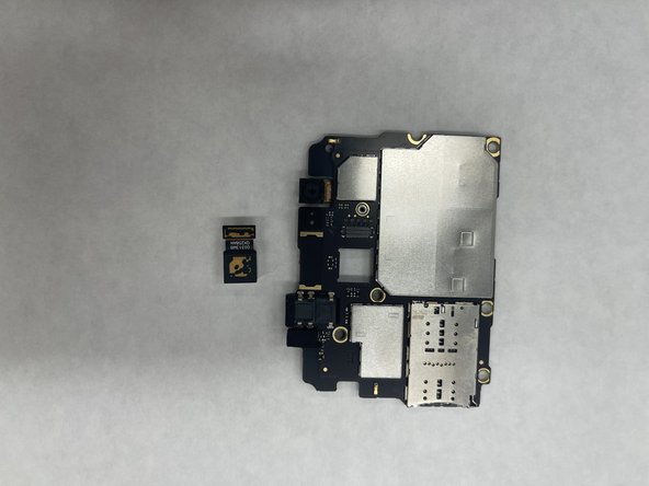

  9. ZTE Max XL Motherboard Replacement: crwdns2935265:09crwdnd2935265:01crwdnd2935265:02crwdne2935265:0 ZTE Max XL Motherboard Replacement: crwdns2935265:09crwdnd2935265:02crwdnd2935265:02crwdne2935265:0
    • Use the Spudger to carefully flip the metal clip holding the camera in place, located on the backside of the Motherboard.
  10. ZTE Max XL Motherboard Replacement: crwdns2935265:010crwdnd2935265:01crwdnd2935265:01crwdne2935265:0
    • With the motherboard removed, you can now insert the new motherboard or replace other parts within your phone.
