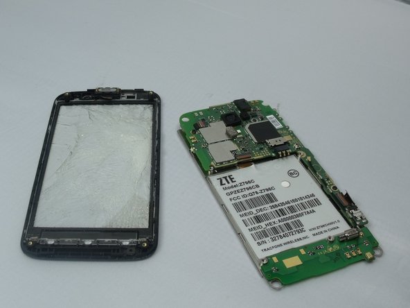

    • Remove the back cover of your phone by placing your finger in the slot located on the back bottom left handed side of the phone.
    • Remove the battery.
  2. ZTE Majesty Screen Replacement: crwdns2935265:02crwdnd2935265:01crwdnd2935265:02crwdne2935265:0 ZTE Majesty Screen Replacement: crwdns2935265:02crwdnd2935265:02crwdnd2935265:02crwdne2935265:0
    • Remove the 9 Phillips- Head screws with a Ph000 screwdriver
    • Using your pry tool, slide it along the edges of the phone closest to the screen. This releases the screen from the housing.
  3. ZTE Majesty Screen Replacement: crwdns2935265:03crwdnd2935265:01crwdnd2935265:01crwdne2935265:0
    • Gently pry back the screen connector on the motherboard. Be careful not to exert too much force because it can easily tear.
  4. ZTE Majesty Screen Replacement: crwdns2935265:04crwdnd2935265:01crwdnd2935265:02crwdne2935265:0 ZTE Majesty Screen Replacement: crwdns2935265:04crwdnd2935265:02crwdnd2935265:02crwdne2935265:0
    • Use your pick to separate screen from the LCD and motherboard.
    • Replace old screen with new screen.
    • Before you put all necessary parts back on your device place the battery back in the slot it goes and power on your device. This ensures that your screen is working properly.
