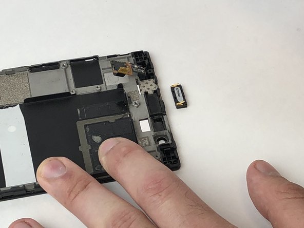

  21. ZTE Lever Loud Speaker Replacement, Loud Speaker: crwdns2935265:021crwdnd2935265:01crwdnd2935265:02crwdne2935265:0 ZTE Lever Loud Speaker Replacement, Loud Speaker: crwdns2935265:021crwdnd2935265:02crwdnd2935265:02crwdne2935265:0
    • Using the plastic opening tool, remove the speaker.
