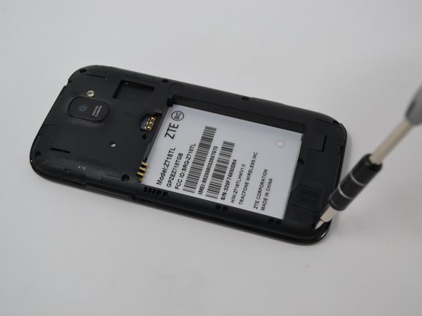

    • Insert the spudger into the bottom left corner of the phone.
    • Use the spudger to loosen the back cover.
  2. ZTE Jasper LTE Screen Replacement: crwdns2935265:02crwdnd2935265:01crwdnd2935265:01crwdne2935265:0
    • Insert the black spudger near the bottom left of the battery. There will be an opening to easily to remove the battery.
    • Continuing to use tool, prop up the battery and remove it.

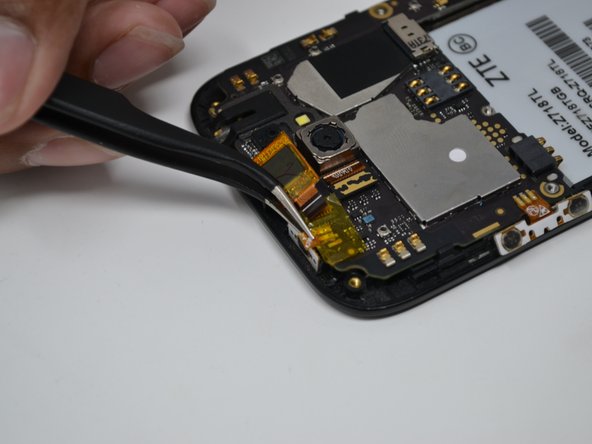

  5. ZTE Jasper LTE Screen Replacement: crwdns2935265:05crwdnd2935265:01crwdnd2935265:03crwdne2935265:0 ZTE Jasper LTE Screen Replacement: crwdns2935265:05crwdnd2935265:02crwdnd2935265:03crwdne2935265:0 ZTE Jasper LTE Screen Replacement: crwdns2935265:05crwdnd2935265:03crwdnd2935265:03crwdne2935265:0
    • Disconnect the gold component attached to the camera by pulling upwards using the tweezers.
    • Remove the camera using the tweezers by gripping tightly around the camera and pulling upwards.
    • Camera is attached to the motherboard with adhesive. As such, you may need to use light force to remove the camera.

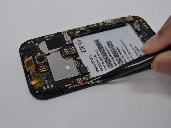

  6. ZTE Jasper LTE Screen Replacement, Screen: crwdns2935265:06crwdnd2935265:01crwdnd2935265:01crwdne2935265:0
    • Disconnect all of these parts from the motherboard.

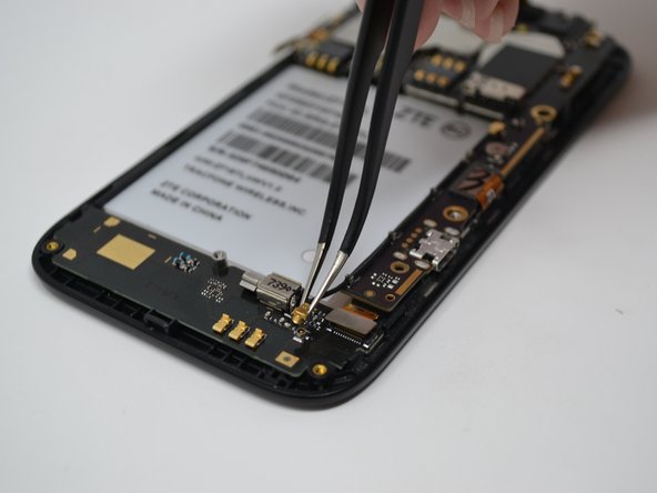

  7. ZTE Jasper LTE Screen Replacement: crwdns2935265:07crwdnd2935265:01crwdnd2935265:03crwdne2935265:0 ZTE Jasper LTE Screen Replacement: crwdns2935265:07crwdnd2935265:02crwdnd2935265:03crwdne2935265:0 ZTE Jasper LTE Screen Replacement: crwdns2935265:07crwdnd2935265:03crwdnd2935265:03crwdne2935265:0
    • Remove the 0.8mm Phillips #00 screw from the bottom right.
    • Disconnect the gold pin by pulling upwards with the tweezers.

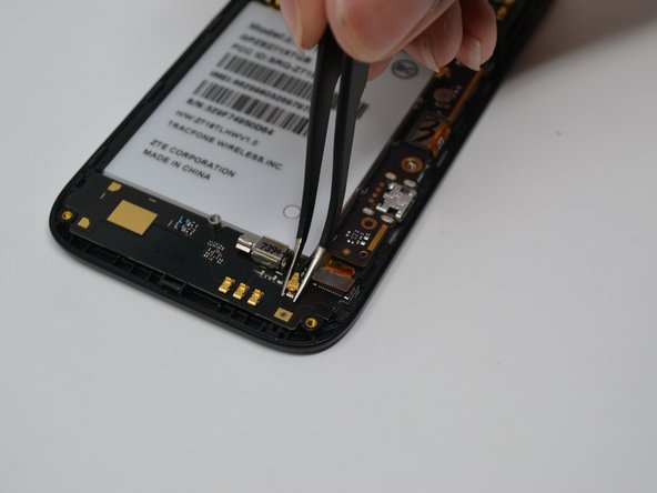

  8. ZTE Jasper LTE Screen Replacement: crwdns2935265:08crwdnd2935265:01crwdnd2935265:03crwdne2935265:0 ZTE Jasper LTE Screen Replacement: crwdns2935265:08crwdnd2935265:02crwdnd2935265:03crwdne2935265:0 ZTE Jasper LTE Screen Replacement: crwdns2935265:08crwdnd2935265:03crwdnd2935265:03crwdne2935265:0
    • Lightly disconnect the power button, volume button and the chip from the motherboard.
    • Be careful not to tear the volume and power button off the motherboard.

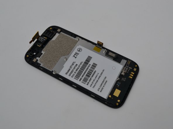

  9. ZTE Jasper LTE Screen Replacement: crwdns2935265:09crwdnd2935265:01crwdnd2935265:02crwdne2935265:0 ZTE Jasper LTE Screen Replacement: crwdns2935265:09crwdnd2935265:02crwdnd2935265:02crwdne2935265:0
    • Lightly move clip back to release the motherboard.
    • Gently pull the motherboard away from the screen.
