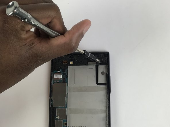

    • Use a screwdriver with a JIS #000 head to remove the (8) eight screws.

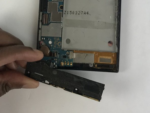

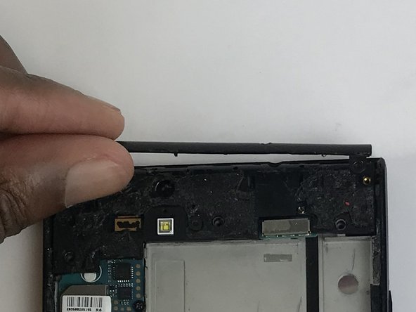

  8. ZTE Grand X Max Plus Motherboard Replacement: crwdns2935265:08crwdnd2935265:01crwdnd2935265:02crwdne2935265:0 ZTE Grand X Max Plus Motherboard Replacement: crwdns2935265:08crwdnd2935265:02crwdnd2935265:02crwdne2935265:0
    • Use a plastic opening tool to remove the plastic piece in the upper part of the phone.

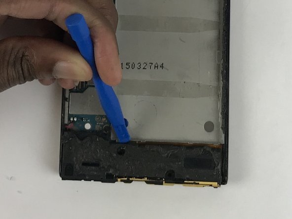

  9. ZTE Grand X Max Plus Motherboard Replacement: crwdns2935265:09crwdnd2935265:01crwdnd2935265:02crwdne2935265:0 ZTE Grand X Max Plus Motherboard Replacement: crwdns2935265:09crwdnd2935265:02crwdnd2935265:02crwdne2935265:0
    • Use the same tool to pry off the plastic that is covering the motherboard.

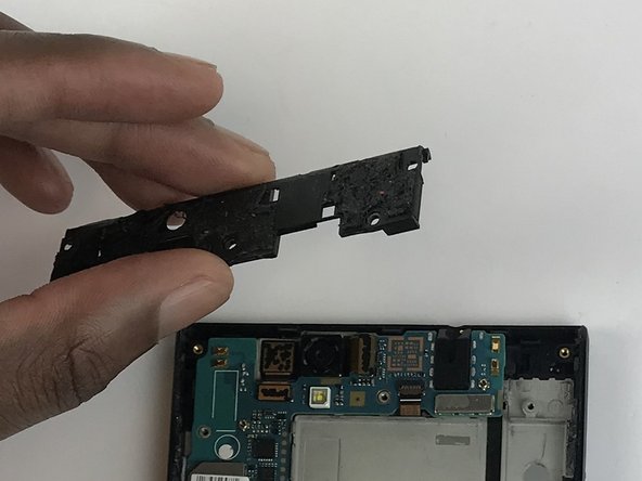

  10. ZTE Grand X Max Plus Motherboard Replacement: crwdns2935265:010crwdnd2935265:01crwdnd2935265:03crwdne2935265:0 ZTE Grand X Max Plus Motherboard Replacement: crwdns2935265:010crwdnd2935265:02crwdnd2935265:03crwdne2935265:0 ZTE Grand X Max Plus Motherboard Replacement: crwdns2935265:010crwdnd2935265:03crwdnd2935265:03crwdne2935265:0
    • Repeat the same steps for the bottom part.
