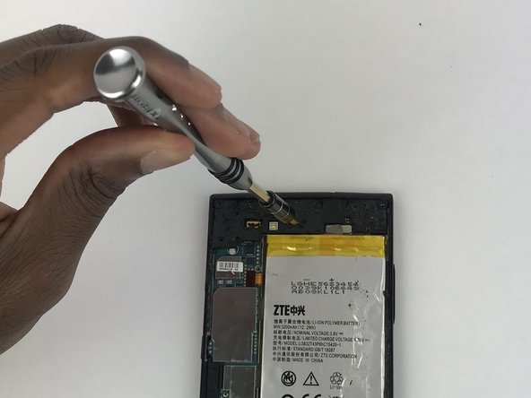

  4. ZTE Grand X Max Plus Camera Replacement, Rear Camera: crwdns2935265:04crwdnd2935265:01crwdnd2935265:02crwdne2935265:0 ZTE Grand X Max Plus Camera Replacement, Rear Camera: crwdns2935265:04crwdnd2935265:02crwdnd2935265:02crwdne2935265:0
    • Remove the screws from the upper part of the phone using a screwdriver with a JIS #000 head. There are (6) six screws that should be removed.

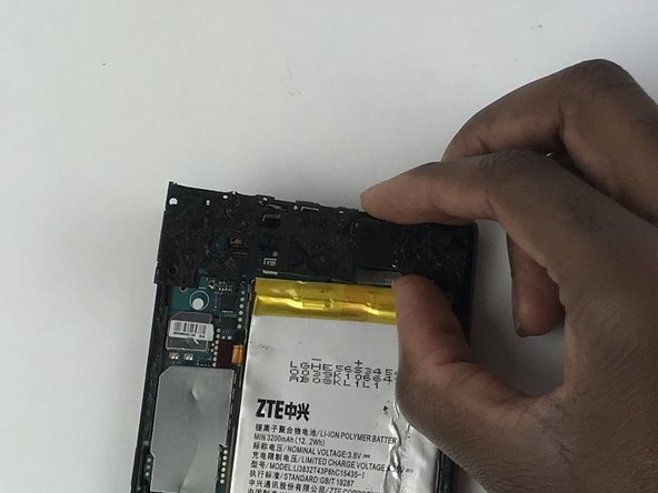

  5. ZTE Grand X Max Plus Camera Replacement: crwdns2935265:05crwdnd2935265:01crwdnd2935265:03crwdne2935265:0 ZTE Grand X Max Plus Camera Replacement: crwdns2935265:05crwdnd2935265:02crwdnd2935265:03crwdne2935265:0 ZTE Grand X Max Plus Camera Replacement: crwdns2935265:05crwdnd2935265:03crwdnd2935265:03crwdne2935265:0
    • Use a plastic opening tool to remove the plastic piece that is protecting the motherboard.

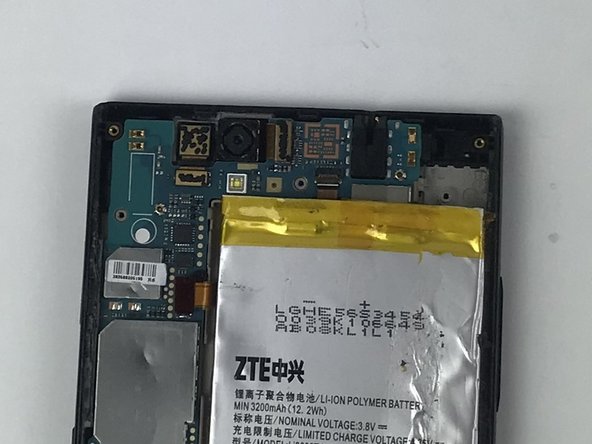

  6. ZTE Grand X Max Plus Camera Replacement: crwdns2935265:06crwdnd2935265:01crwdnd2935265:01crwdne2935265:0
    • With a plastic opening tool, unclip the camera from the motherboard.
  7. ZTE Grand X Max Plus Camera Replacement: crwdns2935265:07crwdnd2935265:01crwdnd2935265:03crwdne2935265:0 ZTE Grand X Max Plus Camera Replacement: crwdns2935265:07crwdnd2935265:02crwdnd2935265:03crwdne2935265:0 ZTE Grand X Max Plus Camera Replacement: crwdns2935265:07crwdnd2935265:03crwdnd2935265:03crwdne2935265:0
    • After the camera is unclipped, remove it from the device.
