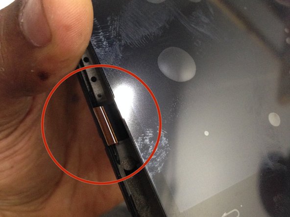

    • JUST LIFT IT UP FROM THE CORNER WITH A FLAT HEAD OR A SIMILAR TOOL FROM THE ONE YOU SEE ON THE PIC

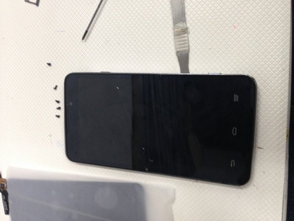

    • THE YELLOW SCREWS AS SHOWN ON THE PIC WILL AVOID YOUR WARRANTY, JUST USE A PHILLIP SCREWDRIVER TO TAKE OUT THE SCREW.
  3. ZTE Boost MAX N9520 Display Assembly Replacement: crwdns2935265:03crwdnd2935265:01crwdnd2935265:02crwdne2935265:0 ZTE Boost MAX N9520 Display Assembly Replacement: crwdns2935265:03crwdnd2935265:02crwdnd2935265:02crwdne2935265:0
    • LIFT UP THE BACK WITH A FLAT HEAD OR A SIMILAR TOOL TO A FLAT HEAD , SO YOU CAN REMOVE THE BACK COMPLETELY

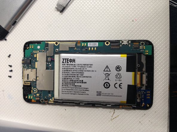

    • WITH A PHILLIP SCREW DRIVER REMOVE THOSE OTHER SCREWS.
    • WITH A FLAT HEAD REMOVE THE RIBBONS AND THE BATTERY CONNECTORS
  5. ZTE Boost MAX N9520 Display Assembly Replacement: crwdns2935265:05crwdnd2935265:01crwdnd2935265:02crwdne2935265:0 ZTE Boost MAX N9520 Display Assembly Replacement: crwdns2935265:05crwdnd2935265:02crwdnd2935265:02crwdne2935265:0
    • WITH A HEATING GUN HEAT THE BACK AND FRONT SO THE GLUE CAN BE REMOVED MORE EASILY

    • AFTER YOU APPLY THE ADHESIVE TAPE JUST PUT THE SCREEN ON THE CORRECT POSITION AND MAKE SURE YOU PUSH THE RIBBONS CORRECTLY

So how do you get the battery connector unplugged?
jeremylester56 - crwdns2934203:0crwdne2934203:0 crwdns2950251:0crwdne2950251:0
take a small flat head screw driver stick it under the white connector (from the side that has the red wire) pry upwards and it will come off. its wedged into the plastic encasing. dont stick the Flathead in all the way you might damage the connectors underneath.
h2kwireless - crwdns2950251:0crwdne2950251:0
Use the black tabs stuck on the bottom of the battery to lift the battery up... assuming you have removed all bolts and flat cables as instructed up to this point. when you do this, work it back and forth applying heat from a heat gun or hair dryer. the battery will eventually give way and you can take the entire circuit board and battery and lay it over on its backside next to the screen.
Take your heat gun or blow dryer and apply heat to the volume buttons still stuck to the side of the screen, remove the buttons.
Now apply a great amount of heat, front and back, until it's very warm to the touch, push through the small holes located on the back of the screen housing to apply pressure on the back of the screen. Keep applying pressure to those holes and eventually the screen will start to give way enough to get a spudger in and work the screen the rest of the way out.
