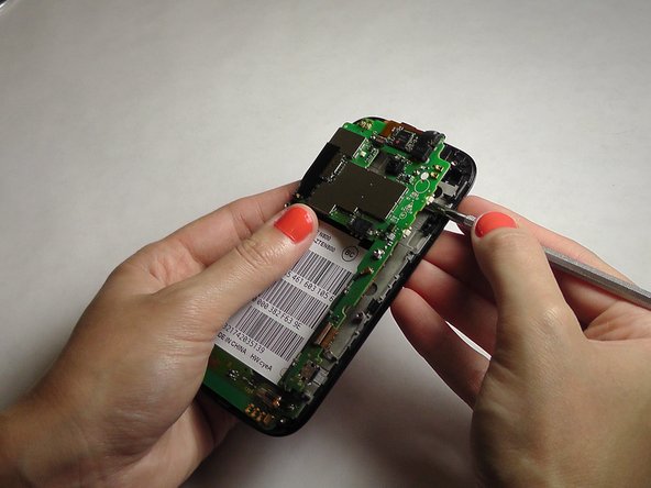

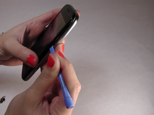

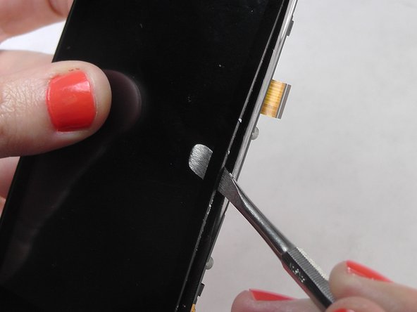

    2. ZTE Awe Screen Replacement, Separate the mid frame and the digitizer: crwdns2935265:02crwdnd2935265:01crwdnd2935265:03crwdne2935265:0 ZTE Awe Screen Replacement, Separate the mid frame and the digitizer: crwdns2935265:02crwdnd2935265:02crwdnd2935265:03crwdne2935265:0 ZTE Awe Screen Replacement, Separate the mid frame and the digitizer: crwdns2935265:02crwdnd2935265:03crwdnd2935265:03crwdne2935265:0
      • Wedge the flat end of the spudger between the mid frame and the digitizer.
    3. ZTE Awe Screen Replacement, Expose the motherboard: crwdns2935265:03crwdnd2935265:01crwdnd2935265:02crwdne2935265:0 ZTE Awe Screen Replacement, Expose the motherboard: crwdns2935265:03crwdnd2935265:02crwdnd2935265:02crwdne2935265:0
      • Gently pry the mid frame away from the rest of the phone to expose the motherboard.

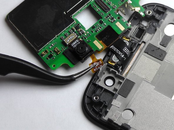

    4. ZTE Awe Screen Replacement, Remove the ribbon wires: crwdns2935265:04crwdnd2935265:01crwdnd2935265:03crwdne2935265:0 ZTE Awe Screen Replacement, Remove the ribbon wires: crwdns2935265:04crwdnd2935265:02crwdnd2935265:03crwdne2935265:0 ZTE Awe Screen Replacement, Remove the ribbon wires: crwdns2935265:04crwdnd2935265:03crwdnd2935265:03crwdne2935265:0
      • Use the tweezers to remove the four ribbon wires on the sides of the device.

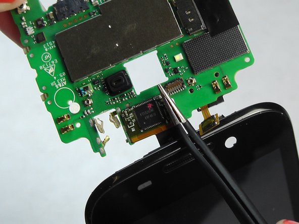

    6. ZTE Awe Screen Replacement, Remove the connector: crwdns2935265:06crwdnd2935265:01crwdnd2935265:03crwdne2935265:0 ZTE Awe Screen Replacement, Remove the connector: crwdns2935265:06crwdnd2935265:02crwdnd2935265:03crwdne2935265:0 ZTE Awe Screen Replacement, Remove the connector: crwdns2935265:06crwdnd2935265:03crwdnd2935265:03crwdne2935265:0
      • Remove the connector to free the motherboard from the screen.

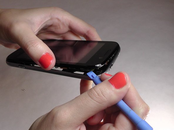

    3. ZTE Awe Screen Replacement: crwdns2935265:09crwdnd2935265:01crwdnd2935265:03crwdne2935265:0 ZTE Awe Screen Replacement: crwdns2935265:09crwdnd2935265:02crwdnd2935265:03crwdne2935265:0 ZTE Awe Screen Replacement: crwdns2935265:09crwdnd2935265:03crwdnd2935265:03crwdne2935265:0
      • Gently wedge the spudger in between the glass screen and the mid frame.

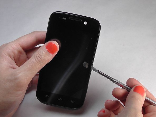

    7. ZTE Awe Screen Replacement, Expose the digitizer: crwdns2935265:013crwdnd2935265:01crwdnd2935265:03crwdne2935265:0 ZTE Awe Screen Replacement, Expose the digitizer: crwdns2935265:013crwdnd2935265:02crwdnd2935265:03crwdne2935265:0 ZTE Awe Screen Replacement, Expose the digitizer: crwdns2935265:013crwdnd2935265:03crwdnd2935265:03crwdne2935265:0
      • Wedge the plastic spudger between the screen and the digitizer.
      • Gently pry apart the screen from the digitizer.
