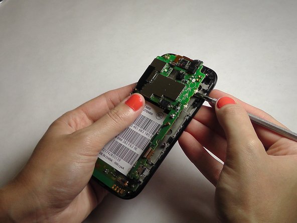

    • Wedge the flat end of the spudger between the mid frame and the digitizer.
  5. ZTE Awe Motherboard Replacement, Expose the motherboard: crwdns2935265:05crwdnd2935265:01crwdnd2935265:02crwdne2935265:0 ZTE Awe Motherboard Replacement, Expose the motherboard: crwdns2935265:05crwdnd2935265:02crwdnd2935265:02crwdne2935265:0
    • Gently pry the mid frame away from the rest of the phone to expose the motherboard.
  6. ZTE Awe Motherboard Replacement, Remove the ribbon wires: crwdns2935265:06crwdnd2935265:01crwdnd2935265:03crwdne2935265:0 ZTE Awe Motherboard Replacement, Remove the ribbon wires: crwdns2935265:06crwdnd2935265:02crwdnd2935265:03crwdne2935265:0 ZTE Awe Motherboard Replacement, Remove the ribbon wires: crwdns2935265:06crwdnd2935265:03crwdnd2935265:03crwdne2935265:0
    • Use the tweezers to remove the four ribbon wires on the sides of the device.
  7. ZTE Awe Motherboard Replacement, Orient the motherboard: crwdns2935265:07crwdnd2935265:01crwdnd2935265:01crwdne2935265:0
    • Orient the motherboard to expose the mid frame.
  8. ZTE Awe Motherboard Replacement, Remove the connector: crwdns2935265:08crwdnd2935265:01crwdnd2935265:03crwdne2935265:0 ZTE Awe Motherboard Replacement, Remove the connector: crwdns2935265:08crwdnd2935265:02crwdnd2935265:03crwdne2935265:0 ZTE Awe Motherboard Replacement, Remove the connector: crwdns2935265:08crwdnd2935265:03crwdnd2935265:03crwdne2935265:0
    • Remove the connector to free the motherboard from the screen.
