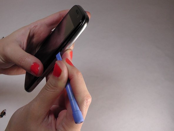

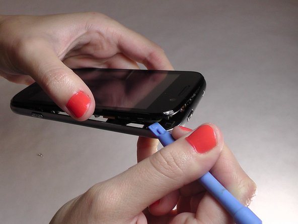

  4. ZTE Awe Headphone Jack Replacement, Separate the mid frame and the digitizer: crwdns2935265:04crwdnd2935265:01crwdnd2935265:03crwdne2935265:0 ZTE Awe Headphone Jack Replacement, Separate the mid frame and the digitizer: crwdns2935265:04crwdnd2935265:02crwdnd2935265:03crwdne2935265:0 ZTE Awe Headphone Jack Replacement, Separate the mid frame and the digitizer: crwdns2935265:04crwdnd2935265:03crwdnd2935265:03crwdne2935265:0
    • Wedge the flat end of the spudger between the mid frame and the digitizer.

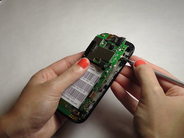

  5. ZTE Awe Headphone Jack Replacement, Expose the motherboard: crwdns2935265:05crwdnd2935265:01crwdnd2935265:02crwdne2935265:0 ZTE Awe Headphone Jack Replacement, Expose the motherboard: crwdns2935265:05crwdnd2935265:02crwdnd2935265:02crwdne2935265:0
    • Gently pry the mid frame away from the rest of the phone to expose the motherboard.

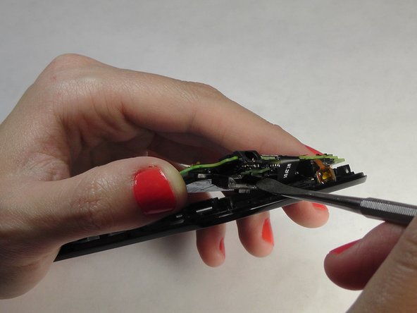

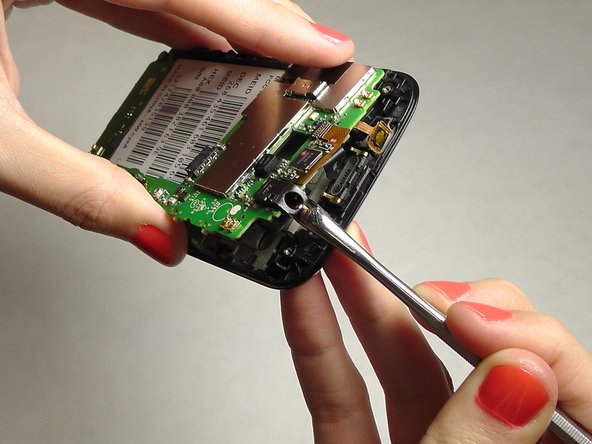

  6. ZTE Awe Headphone Jack Replacement, Remove the audio jack: crwdns2935265:06crwdnd2935265:01crwdnd2935265:03crwdne2935265:0 ZTE Awe Headphone Jack Replacement, Remove the audio jack: crwdns2935265:06crwdnd2935265:02crwdnd2935265:03crwdne2935265:0 ZTE Awe Headphone Jack Replacement, Remove the audio jack: crwdns2935265:06crwdnd2935265:03crwdnd2935265:03crwdne2935265:0
    • Locate the audio jack at the upper right hand corner of the device.
    • Use the metal spudger to pry the motherboard away from the device.
    • Use the metal spudger to unfasten the audio jack and pull it away from the motherboard.
