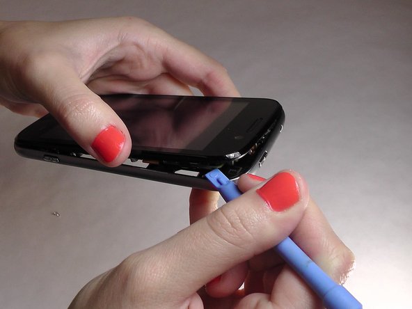

  4. ZTE Awe Camera Replacement, Unscrew the mid frame: crwdns2935265:04crwdnd2935265:01crwdnd2935265:01crwdne2935265:0
    • Use the Phillips Head 00 screw driver to unscrew the seven 0.1mm screws along the perimeter of the phone's mid frame.

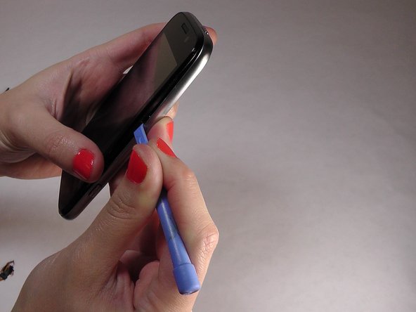

  5. ZTE Awe Camera Replacement, Separate the mid frame and the digitizer: crwdns2935265:05crwdnd2935265:01crwdnd2935265:03crwdne2935265:0 ZTE Awe Camera Replacement, Separate the mid frame and the digitizer: crwdns2935265:05crwdnd2935265:02crwdnd2935265:03crwdne2935265:0 ZTE Awe Camera Replacement, Separate the mid frame and the digitizer: crwdns2935265:05crwdnd2935265:03crwdnd2935265:03crwdne2935265:0
    • Wedge the flat end of the spudger between the mid frame and the digitizer.

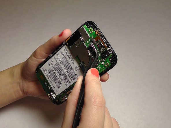

  6. ZTE Awe Camera Replacement, Expose the motherboard: crwdns2935265:06crwdnd2935265:01crwdnd2935265:03crwdne2935265:0 ZTE Awe Camera Replacement, Expose the motherboard: crwdns2935265:06crwdnd2935265:02crwdnd2935265:03crwdne2935265:0 ZTE Awe Camera Replacement, Expose the motherboard: crwdns2935265:06crwdnd2935265:03crwdnd2935265:03crwdne2935265:0
    • Gently pry the mid frame away from the rest of the phone to expose the motherboard.

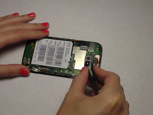

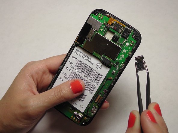

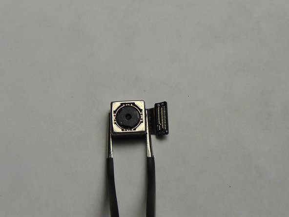

  7. ZTE Awe Camera Replacement, Remove the camera: crwdns2935265:07crwdnd2935265:01crwdnd2935265:03crwdne2935265:0 ZTE Awe Camera Replacement, Remove the camera: crwdns2935265:07crwdnd2935265:02crwdnd2935265:03crwdne2935265:0 ZTE Awe Camera Replacement, Remove the camera: crwdns2935265:07crwdnd2935265:03crwdnd2935265:03crwdne2935265:0
    • Use the tweezers to grip the back facing camera. Gently pull until the camera is completely removed from the motherboard.
