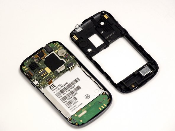

  4. ZTE Avail 2 Camera Replacement: crwdns2935265:04crwdnd2935265:01crwdnd2935265:02crwdne2935265:0 ZTE Avail 2 Camera Replacement: crwdns2935265:04crwdnd2935265:02crwdnd2935265:02crwdne2935265:0
    • Using the spudger tool, pull up from underneath the back plate and pop off the piece.

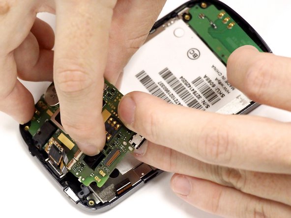

  7. ZTE Avail 2 Camera Replacement: crwdns2935265:07crwdnd2935265:01crwdnd2935265:02crwdne2935265:0 ZTE Avail 2 Camera Replacement: crwdns2935265:07crwdnd2935265:02crwdnd2935265:02crwdne2935265:0
    • Lift up the motherboard, this may require some force because it is held on by adhesive.
    • This will allow you to access the camera and the camera mount.

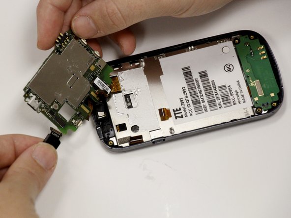

  8. ZTE Avail 2 Camera Replacement: crwdns2935265:08crwdnd2935265:01crwdnd2935265:03crwdne2935265:0 ZTE Avail 2 Camera Replacement: crwdns2935265:08crwdnd2935265:02crwdnd2935265:03crwdne2935265:0 ZTE Avail 2 Camera Replacement: crwdns2935265:08crwdnd2935265:03crwdnd2935265:03crwdne2935265:0
    • Where you can see the front of the camera lightly push on the camera to remove the camera from its holding. The camera will come through the back.
    • Once out of the holding remove the clip holding it to the underside of the motherboard. Now the camera is removed.
    • Once the old camera is removed replace it with the new camera to complete the repair.
