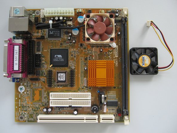

  4. ZPrinter 650 Mainboard Replacement, Prepare the New Mainboard for Installation: crwdns2935265:04crwdnd2935265:01crwdnd2935265:02crwdne2935265:0 ZPrinter 650 Mainboard Replacement, Prepare the New Mainboard for Installation: crwdns2935265:04crwdnd2935265:02crwdnd2935265:02crwdne2935265:0
    • Once you have confirmed that you have a faulty mainboard and purchased a replacement, you need to prepare it before installation.
    • Begin by replacing the original fan as a preventative measure to avoid future issues. Use the best fluid dynamic bearing fan you can find, such as the Noctua NF-A4x10 FLX featured in the photo. Any other high quality 40x40x10 mm fan with a 12V 3-pin connector will work as well. Don't forget to connect the fan cable.
    • Next, replace the original CMOS battery (CR2032 type) as a preventative measure, as the mainboard may have been in a warehouse for eight or more years, causing the original battery to die.
    • Caution: Be aware that some variants of the mainboard do not come equipped with a CPU fan. If this is the case, you must add a fan to prevent the CPU from overheating and burning out.
    • Mainboards produced at different times may use different screws for the CPU fan, which may present some difficulties during installation. If necessary, purchase 2.5x15 mm wood screws or M2.5x15 screws with washers.

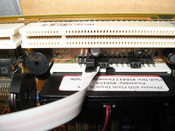

    • DDR memory stick
    • Small Parallel ATA solid state hard drive
    • Power supply converter and connector
    • White ribbon cable for the "power button" header
    • It's important to connect the white flat cable exactly as shown in the second photo, otherwise the printer signal will not be able to boot up the mainboard. Also, ensure that you put the hard drive into the correct PATA slot.
    • If you can, make a backup of the drive (see Step 8 as to why). You will need another PC with a PATA adapter and imaging software for this task because there are several different partitions on it. The drive is powered via thin cable from Molex connector, so you will need to borrow it from the printer. The drive has 64 MB capacity.

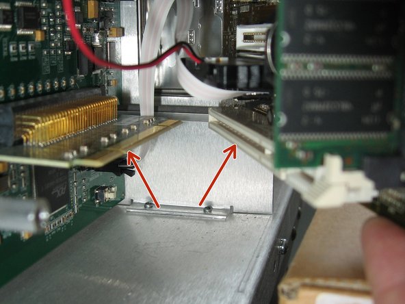

    • This part is a bit tricky, because you need to connect the mainboard onto PCI riser card as you slide it in.
    • Begin by placing the mainboard connectors onto the I/O shield at an angle, as shown in the first photo.
    • Gently push the left edge of the board and verify that the riser card is properly mating with the PCI slot, indicated by green arrows in the second photo.
    • If everything looks good, push the mainboard all the way onto the hexagonal mounting posts and secure it in place with screws

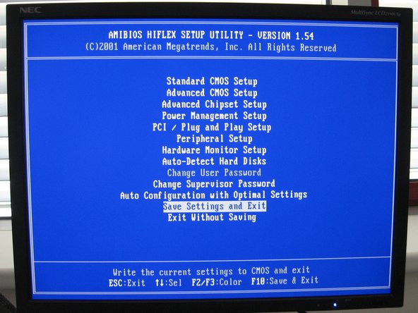

    • Connect a PS/2 keyboard and a VGA monitor to the mainboard. Plug in the power cord of the printer and turn it on. The mainboard should beep and show the BIOS logo. It may stop and report corrupted CMOS settings due to the battery replacement in Step 4.
    • Enter the BIOS by pressing the Delete or F1 key and choose to Save settings, as shown in the second photo. This will save default CMOS settings and the mainboard will reboot itself. It should then boot into the printer firmware, with an ASCII GUI similar to the third photo. The small display at the front of the printer should also function now.
    • If you encounter any issues, troubleshoot as you would with a regular PC. Check for loose cables/connectors, improperly seated components, faulty power supply, faulty memory, BIOS errors, etc.

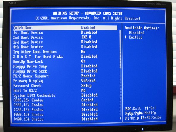

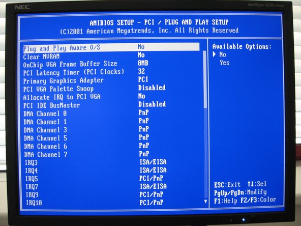

  10. ZPrinter 650 Mainboard Replacement, Configure BIOS Settings, Part 1: crwdns2935265:010crwdnd2935265:01crwdnd2935265:03crwdne2935265:0 ZPrinter 650 Mainboard Replacement, Configure BIOS Settings, Part 1: crwdns2935265:010crwdnd2935265:02crwdnd2935265:03crwdne2935265:0 ZPrinter 650 Mainboard Replacement, Configure BIOS Settings, Part 1: crwdns2935265:010crwdnd2935265:03crwdnd2935265:03crwdne2935265:0
    • To prevent the printer firmware from freezing when you connect the Ethernet cable, you must adjust some settings in the BIOS. Specifically, you need to disable certain onboard devices to avoid IRQ conflicts. Since the firmware runs on FreeDOS, which is not a Plug and Play OS, these adjustments are necessary.
    • While I do not recall the exact settings that need to be changed, I have taken photos of a working printer that can serve as a template.
    • Update as of 2022: I have set up a printer with a dead CMOS battery and found that you must set "Floppy Drive A" to "Not Installed".

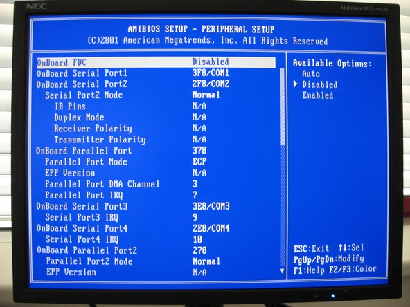

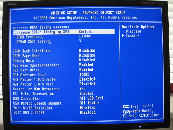

  11. ZPrinter 650 Mainboard Replacement, Configure BIOS Settings, Part 2: crwdns2935265:011crwdnd2935265:01crwdnd2935265:03crwdne2935265:0 ZPrinter 650 Mainboard Replacement, Configure BIOS Settings, Part 2: crwdns2935265:011crwdnd2935265:02crwdnd2935265:03crwdne2935265:0 ZPrinter 650 Mainboard Replacement, Configure BIOS Settings, Part 2: crwdns2935265:011crwdnd2935265:03crwdnd2935265:03crwdne2935265:0
    • iFixit limits the number of photos per step to three, as such I had to split the BIOS settings into two steps. Notably, the Peripheral Setup setting is likely the most crucial.
    • Once you have adjusted the necessary settings, remember to save them before allowing the printer to boot into its ASCII GUI.
    • Update as of 2022: I recently configured a printer with a dead CMOS battery and found that you must set "Onboard FDC" to "Disabled".

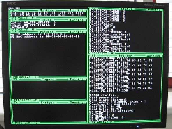

  12. ZPrinter 650 Mainboard Replacement, Test Printer for Networked Functionality: crwdns2935265:012crwdnd2935265:01crwdnd2935265:03crwdne2935265:0 ZPrinter 650 Mainboard Replacement, Test Printer for Networked Functionality: crwdns2935265:012crwdnd2935265:02crwdnd2935265:03crwdne2935265:0 ZPrinter 650 Mainboard Replacement, Test Printer for Networked Functionality: crwdns2935265:012crwdnd2935265:03crwdnd2935265:03crwdne2935265:0

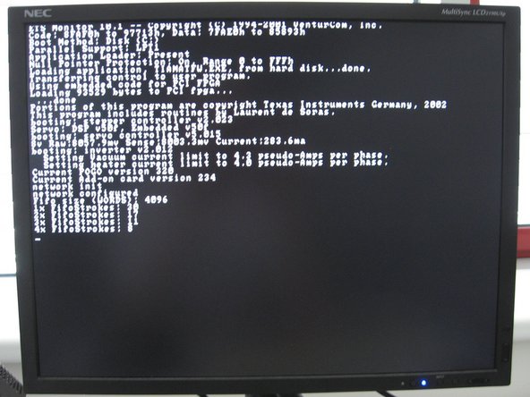

    • Connect the Ethernet cable to the printer and observe the ASCII GUI. Normally, some values change every second and should continue to do so after you plug in the cable. If the firmware freezes, double-check the BIOS settings.
    • During boot, the firmware displays various information (as shown in the second photo). If the printer consistently freezes at a particular stage upon rebooting, that may be the issue. Unfortunately, the only way to reboot from frozen firmware is to turn the printer off and on again.

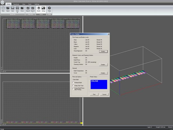

    • The printer should now function correctly. You should be able to connect to it immediately with ZPrint or 3DPrint software because all settings were saved on its internal HDD. Keep in mind that the new mainboard has a different MAC address, so network configuration changes may be necessary in your institution/workplace.
Finally, you should turn off the printer, disconnect all cables and put back cover on the electronics module. That completes the repair.
