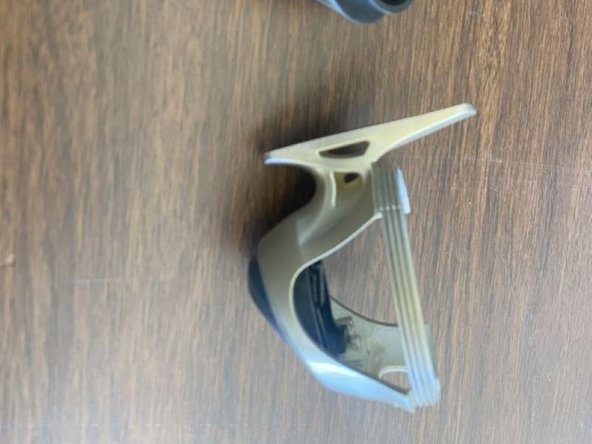

    • remove front cover assembly (red cap)
    • turn assembly cap counterclockwise

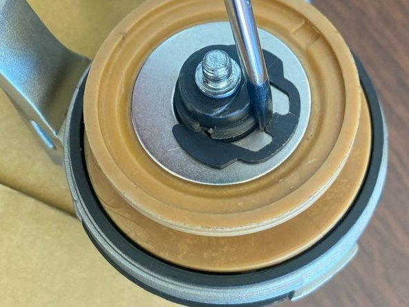

  2. ZEBCO 202k Teardown: crwdns2935265:02crwdnd2935265:01crwdnd2935265:01crwdne2935265:0
    • Takeoff spinner head assembly. (metal cap)
    • Hold the handle and turn spinner head assembly counterclockwise
  3. ZEBCO 202k Teardown: crwdns2935265:03crwdnd2935265:01crwdnd2935265:03crwdne2935265:0 ZEBCO 202k Teardown: crwdns2935265:03crwdnd2935265:02crwdnd2935265:03crwdne2935265:0 ZEBCO 202k Teardown: crwdns2935265:03crwdnd2935265:03crwdnd2935265:03crwdne2935265:0
    • Use flat head to remove the spool clip
    • remember order of washers for assembly.
    • after removing spool clip washer, you can also pull out spool

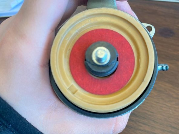

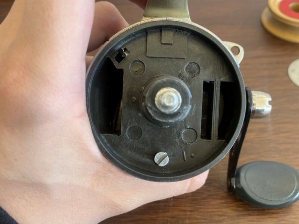

  4. ZEBCO 202k Teardown: crwdns2935265:04crwdnd2935265:01crwdnd2935265:03crwdne2935265:0 ZEBCO 202k Teardown: crwdns2935265:04crwdnd2935265:02crwdnd2935265:03crwdne2935265:0 ZEBCO 202k Teardown: crwdns2935265:04crwdnd2935265:03crwdnd2935265:03crwdne2935265:0
    • Underneath the spool there will be a thin washer and a drag adjuster spring.
    • lift up to remove

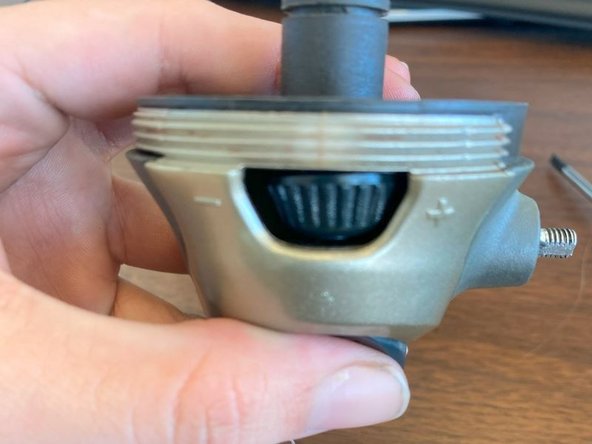

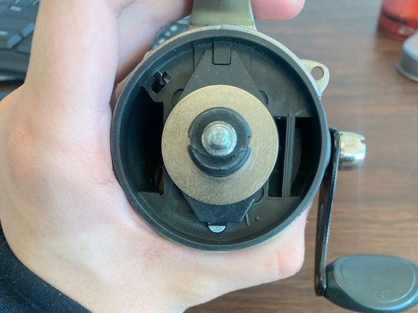

  6. ZEBCO 202k Teardown: crwdns2935265:06crwdnd2935265:01crwdnd2935265:03crwdne2935265:0 ZEBCO 202k Teardown: crwdns2935265:06crwdnd2935265:02crwdnd2935265:03crwdne2935265:0 ZEBCO 202k Teardown: crwdns2935265:06crwdnd2935265:03crwdnd2935265:03crwdne2935265:0
    • remove back assembly from body assembly by pushing up oppisites side off handle
    • no tools are needed

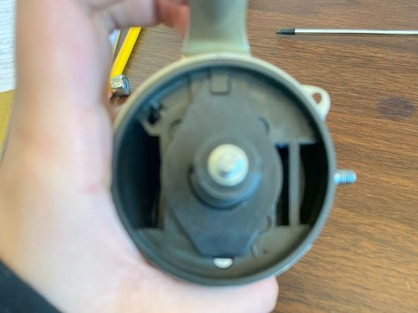

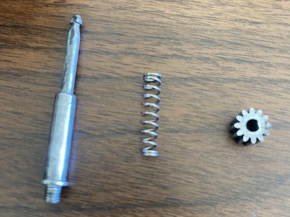

  7. ZEBCO 202k Teardown: crwdns2935265:07crwdnd2935265:01crwdnd2935265:02crwdne2935265:0 ZEBCO 202k Teardown: crwdns2935265:07crwdnd2935265:02crwdnd2935265:02crwdne2935265:0
    • remove spring from center shaft by pulling it by hand or help of flat head
    • center shaft will fall from the middle

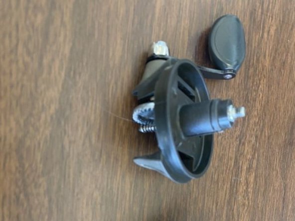

  8. ZEBCO 202k Teardown: crwdns2935265:08crwdnd2935265:01crwdnd2935265:01crwdne2935265:0
    • unscrew handle to remove driven gear and to remove anti reverse.
  9. ZEBCO 202k Teardown: crwdns2935265:09crwdnd2935265:01crwdnd2935265:01crwdne2935265:0

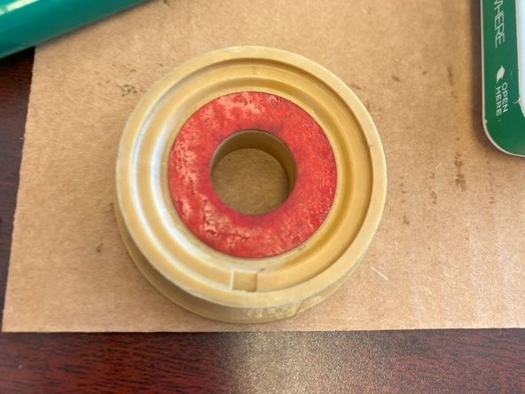

  11. ZEBCO 202k Teardown: crwdns2935265:011crwdnd2935265:01crwdnd2935265:03crwdne2935265:0 ZEBCO 202k Teardown: crwdns2935265:011crwdnd2935265:02crwdnd2935265:03crwdne2935265:0 ZEBCO 202k Teardown: crwdns2935265:011crwdnd2935265:03crwdnd2935265:03crwdne2935265:0
    • insert drag adjuster spring
    • then thin washer
    • spool then red washer and the last whasher
    • at the top you will need to clip in spool clip.
