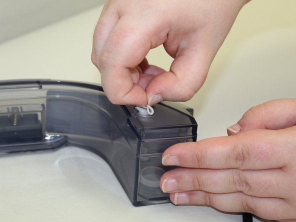

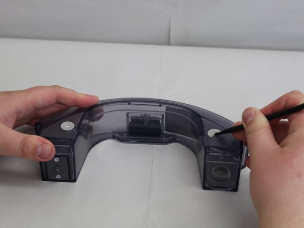

  3. ZCWA BR151 Water Filter Replacement, Water Filter: crwdns2935265:03crwdnd2935265:01crwdnd2935265:03crwdne2935265:0 ZCWA BR151 Water Filter Replacement, Water Filter: crwdns2935265:03crwdnd2935265:02crwdnd2935265:03crwdne2935265:0 ZCWA BR151 Water Filter Replacement, Water Filter: crwdns2935265:03crwdnd2935265:03crwdnd2935265:03crwdne2935265:0
    • Remove the filter holders, on the bottom of the water tank, one at a time by maneuvering the spudger under the flaps of the filter holders.
    • Use the spudger to lift enough of the flap up to pinch it between two fingers.
    • Pull the flap up while pinching it to dislodge the filter holder from the water tank.

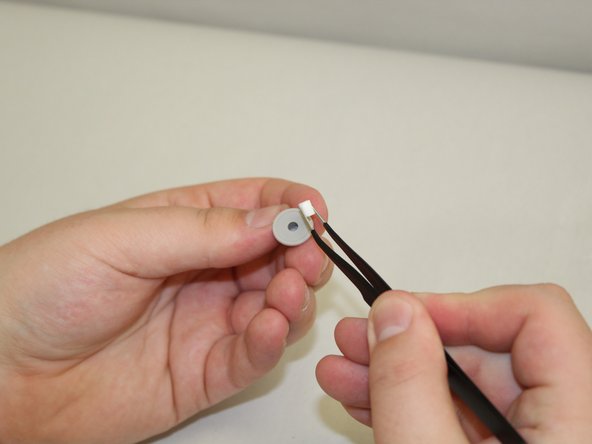

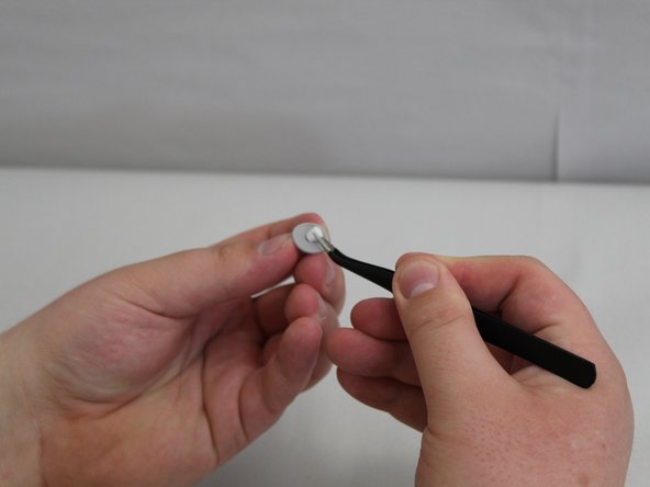

  4. ZCWA BR151 Water Filter Replacement: crwdns2935265:04crwdnd2935265:01crwdnd2935265:03crwdne2935265:0 ZCWA BR151 Water Filter Replacement: crwdns2935265:04crwdnd2935265:02crwdnd2935265:03crwdne2935265:0 ZCWA BR151 Water Filter Replacement: crwdns2935265:04crwdnd2935265:03crwdnd2935265:03crwdne2935265:0
    • To extract the cotton filters, push the flaps of the filter holders down.
    • Use the tweezers to pull out the filter.

How do you get the cotton filters back into the rubber holders ?
