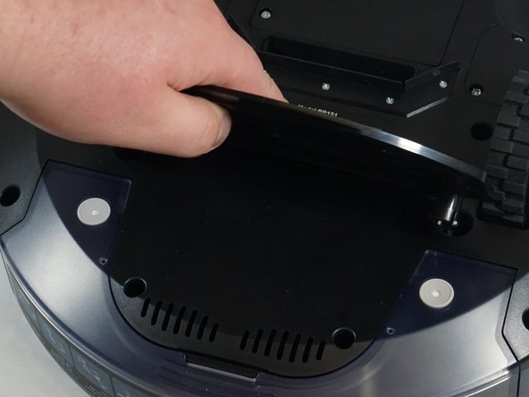

    • Flip the device over to access the bottom panel.
    • Remove the cloth mop covering by lifting it from the velcro on the plastic mop attachment.
    • Remove the plastic mop attachment by placing your fingers underneath and prying it up.

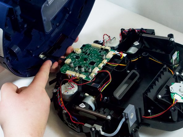

  5. ZCWA BR151 Sprayer/Pump Replacement: crwdns2935265:05crwdnd2935265:01crwdnd2935265:01crwdne2935265:0
    • Use a Phillips #1 screwdriver to remove the ten 10 mm screws from the bottom plate.
  6. ZCWA BR151 Sprayer/Pump Replacement: crwdns2935265:06crwdnd2935265:01crwdnd2935265:02crwdne2935265:0 ZCWA BR151 Sprayer/Pump Replacement: crwdns2935265:06crwdnd2935265:02crwdnd2935265:02crwdne2935265:0
    • Carefully lift the bottom panel off of the top.
    • The top and bottom panels are attached by a set of wires. They will not fully detach at this point.
    • Gently place the bottom of the device on your workspace surface, wheels down, exposing the inner workings of the device.

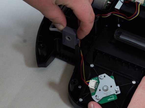

  7. ZCWA BR151 Sprayer/Pump Replacement: crwdns2935265:07crwdnd2935265:01crwdnd2935265:01crwdne2935265:0
    • Though optional, we recommend separating the top and bottom panels for easy access to the sprayer/pump.
    • Pinch the wire bracket that is on the top panel while pulling the bracket away.
    • Pull the cable away from the connector in the same direction as the individual wires are running.
    • Pull evenly on the full width of the cable so that no individual wires are overly strained.
  8. ZCWA BR151 Sprayer/Pump Replacement: crwdns2935265:08crwdnd2935265:01crwdnd2935265:03crwdne2935265:0 ZCWA BR151 Sprayer/Pump Replacement: crwdns2935265:08crwdnd2935265:02crwdnd2935265:03crwdne2935265:0 ZCWA BR151 Sprayer/Pump Replacement: crwdns2935265:08crwdnd2935265:03crwdnd2935265:03crwdne2935265:0
    • The sprayer is slotted in place with grooves. Slide up the sprayer by lifting it up with your fingers.
    • The sprayer/pump should loosely be free, except for wires connecting it to the motherboard.

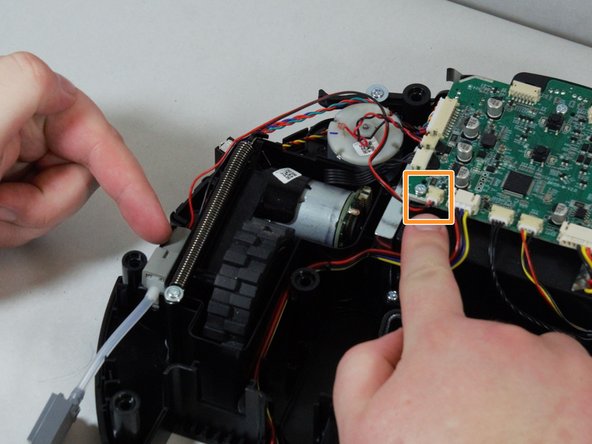

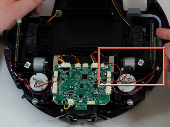

  9. ZCWA BR151 Sprayer/Pump Replacement: crwdns2935265:09crwdnd2935265:01crwdnd2935265:03crwdne2935265:0 ZCWA BR151 Sprayer/Pump Replacement: crwdns2935265:09crwdnd2935265:02crwdnd2935265:03crwdne2935265:0 ZCWA BR151 Sprayer/Pump Replacement: crwdns2935265:09crwdnd2935265:03crwdnd2935265:03crwdne2935265:0
    • Turn the device around so that the motherboard is closest to you.

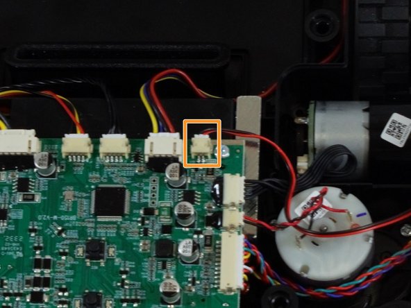

    • Track the red and black wire cables from the sprayer/pump to the motherboard.
    • Remove the sprayer/pump wiring from the port on the motherboard by pinching the silver brackets and pull the wire casing away from the motherboard.
    • Remove the sprayer/pump from the vacuum.
