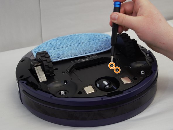

  3. ZCWA BR151 Battery Replacement, Battery: crwdns2935265:03crwdnd2935265:01crwdnd2935265:02crwdne2935265:0 ZCWA BR151 Battery Replacement, Battery: crwdns2935265:03crwdnd2935265:02crwdnd2935265:02crwdne2935265:0
    • Flip the device over to access the panels on the back.
    • Rotate the device to where the battery panel is closest to you.
    • Using a Phillips #1 screwdriver, remove the two 10 mm screws from the battery panel.

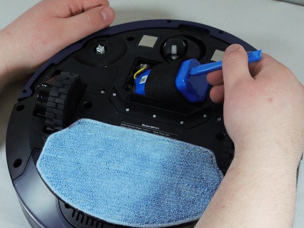

  4. ZCWA BR151 Battery Replacement: crwdns2935265:04crwdnd2935265:01crwdnd2935265:02crwdne2935265:0 ZCWA BR151 Battery Replacement: crwdns2935265:04crwdnd2935265:02crwdnd2935265:02crwdne2935265:0
    • From the opposite end of the battery wires, use an opening tool to pry the battery out.
    • Do not use metal objects to pry out the battery.
    • You may need to rotate the device depending on your hand prominence.

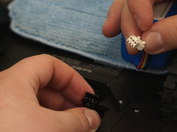

  6. ZCWA BR151 Battery Replacement: crwdns2935265:06crwdnd2935265:01crwdnd2935265:02crwdne2935265:0 ZCWA BR151 Battery Replacement: crwdns2935265:06crwdnd2935265:02crwdnd2935265:02crwdne2935265:0
    • Pinch the two lock mechanisms on the wire connectors while pulling them apart.
    • Set aside the old battery to dispose of later.
