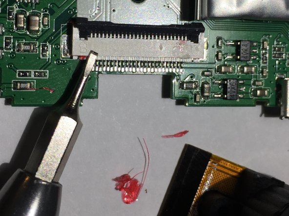

  4. Z-Edge 3 2K HDR HD Dashcam Teardown, Remove the LCD cable from the PCB: crwdns2935265:04crwdnd2935265:01crwdnd2935265:01crwdne2935265:0
    • Look there! Did someone bleed on that FPC connector for the LCD or is that adhesive?
    • Starting at the connector, you can take the 1.0 flat head bit from the ifixit toolkit and carefully scrape the bits of that semi-hard adhesive off the ends of the connector lock. Then slip the spudger between the lock and connector body to release the cable and remove the LCD

    • If you look closely at the FPC cable connector...yep I dinged the hold down piece pretty badly scraping the adhesive...but you'll see I was more gentle and effective with the adhesive on the camera module FPC cable connector!
