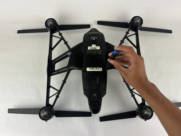

    • Flip the drone upside down.
    • Use a 2 mm Hex screwdriver to remove the two screws that secure the legs to the drone.

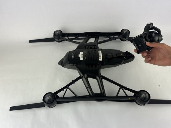

  2. Yuneec Typhoon Q500 4K Bottom Frame Replacement: crwdns2935265:02crwdnd2935265:01crwdnd2935265:02crwdne2935265:0 Yuneec Typhoon Q500 4K Bottom Frame Replacement: crwdns2935265:02crwdnd2935265:02crwdnd2935265:02crwdne2935265:0
    • Turn the drone to the side so that you can get better grip.
    • Put both thumbs on the plastic clamp and detach the legs from the main body.
    • While removing the legs remember to push the whole piece in a forward upward motion.
    • Repeat same steps for other leg.

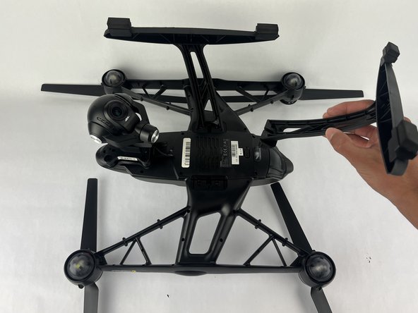

  3. Yuneec Typhoon Q500 4K Bottom Frame Replacement, Bottom Frame: crwdns2935265:03crwdnd2935265:01crwdnd2935265:02crwdne2935265:0 Yuneec Typhoon Q500 4K Bottom Frame Replacement, Bottom Frame: crwdns2935265:03crwdnd2935265:02crwdnd2935265:02crwdne2935265:0
    • Use one hand to hold drone and other to hold camera, then slide the camera off the body of the drone.

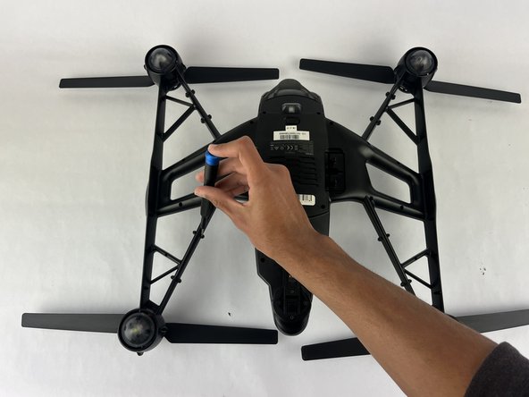

  4. Yuneec Typhoon Q500 4K Bottom Frame Replacement: crwdns2935265:04crwdnd2935265:01crwdnd2935265:03crwdne2935265:0 Yuneec Typhoon Q500 4K Bottom Frame Replacement: crwdns2935265:04crwdnd2935265:02crwdnd2935265:03crwdne2935265:0 Yuneec Typhoon Q500 4K Bottom Frame Replacement: crwdns2935265:04crwdnd2935265:03crwdnd2935265:03crwdne2935265:0
    • Use a TR6 Torx screwdriver to remove the screws connected to the bottom frame.
    • Use a TR8 Torx screwdriver to remove the screws located at the center frame.
    • Use a TR6 Torx screwdriver to remove the screws connecting the center frame to the propellers.
