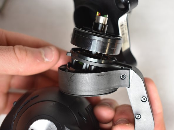

    • Using the Phillips #1 screwdriver, remove the four 6.3 mm motor mount screws on top of the motor piece.
  6. Yuneec Typhoon H Slip Ring Yaw Motor Replacement: crwdns2935265:06crwdnd2935265:01crwdnd2935265:01crwdne2935265:0
    • Once these screws are removed, pop off the top of the motor piece.
  7. Yuneec Typhoon H Slip Ring Yaw Motor Replacement: crwdns2935265:07crwdnd2935265:01crwdnd2935265:02crwdne2935265:0 Yuneec Typhoon H Slip Ring Yaw Motor Replacement: crwdns2935265:07crwdnd2935265:02crwdnd2935265:02crwdne2935265:0

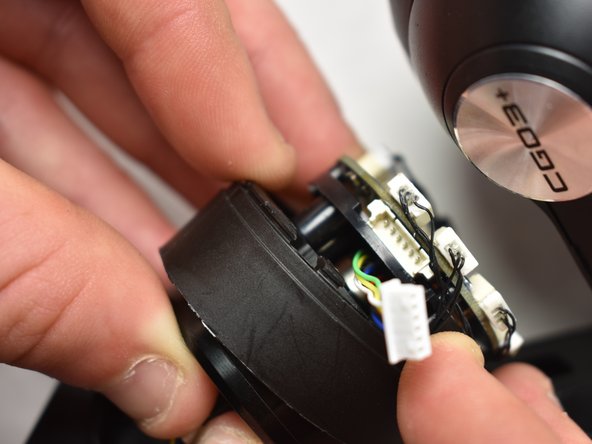

  8. Yuneec Typhoon H Slip Ring Yaw Motor Replacement: crwdns2935265:08crwdnd2935265:01crwdnd2935265:02crwdne2935265:0 Yuneec Typhoon H Slip Ring Yaw Motor Replacement: crwdns2935265:08crwdnd2935265:02crwdnd2935265:02crwdne2935265:0
    • Pull out the white wire connecter that is currently in the wire assembly.

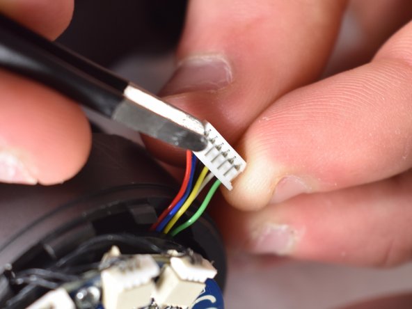

  9. Yuneec Typhoon H Slip Ring Yaw Motor Replacement: crwdns2935265:09crwdnd2935265:01crwdnd2935265:01crwdne2935265:0
    • Remove the white wire connector cap using the tweezers. This is for the wires that are currently in the motor piece. Do take note of the orientation and order of the wires.
  10. Yuneec Typhoon H Slip Ring Yaw Motor Replacement: crwdns2935265:010crwdnd2935265:01crwdnd2935265:02crwdne2935265:0 Yuneec Typhoon H Slip Ring Yaw Motor Replacement: crwdns2935265:010crwdnd2935265:02crwdnd2935265:02crwdne2935265:0
    • Removed the damaged slip ring motor by guiding the wires through the opening in the motor piece. Use a pair of pliers to make sure the wires are pushed through the opening in the center of the motor piece.
