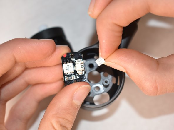

  4. Yuneec Typhoon H LED Board Replacement: crwdns2935265:04crwdnd2935265:01crwdnd2935265:02crwdne2935265:0 Yuneec Typhoon H LED Board Replacement: crwdns2935265:04crwdnd2935265:02crwdnd2935265:02crwdne2935265:0
    • Hold the LED board in one hand and pinch the plug at the connection to the board with the other hand.
    • Pull the plug out from the connection piece.
