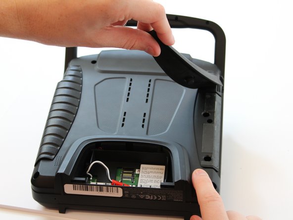

  4. Yuneec ST10 Plus Joystick Replacement, Joystick Removal: crwdns2935265:04crwdnd2935265:01crwdnd2935265:02crwdne2935265:0 Yuneec ST10 Plus Joystick Replacement, Joystick Removal: crwdns2935265:04crwdnd2935265:02crwdnd2935265:02crwdne2935265:0
    • Slide the Jimmy underneath the rubber grips and pry upwards.
    • With your free hand grasp the rubber grips and pull upward to remove it.

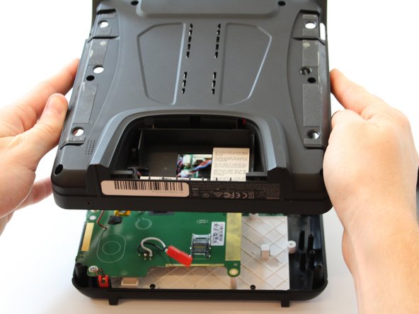

  5. Yuneec ST10 Plus Joystick Replacement: crwdns2935265:05crwdnd2935265:01crwdnd2935265:01crwdne2935265:0
    • Remove the six 1.3 cm screws located on the back panel of the remote using the 5.5mm hex screw bit.
  6. Yuneec ST10 Plus Joystick Replacement: crwdns2935265:06crwdnd2935265:01crwdnd2935265:01crwdne2935265:0
    • Remove the four 6mm screws from the handle using the 4mm hex driver bit.
  7. Yuneec ST10 Plus Joystick Replacement: crwdns2935265:07crwdnd2935265:01crwdnd2935265:02crwdne2935265:0 Yuneec ST10 Plus Joystick Replacement: crwdns2935265:07crwdnd2935265:02crwdnd2935265:02crwdne2935265:0
    • Carefully pull up and over on the back panel to remove. Take your time because there are wires connecting the two panels that can be easily torn.

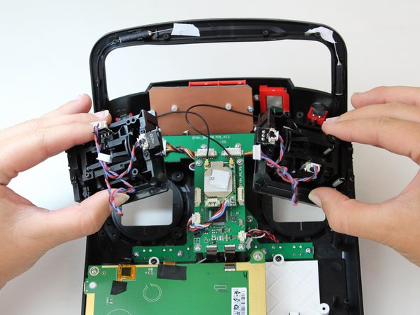

  8. Yuneec ST10 Plus Joystick Replacement: crwdns2935265:08crwdnd2935265:01crwdnd2935265:01crwdne2935265:0
    • Use the nylon tipped tweezers to pull the two joystick cables from their connectors.
    • The cable connectors are located in the middle of the device and are inline with the two joysticks on the motherboard.
  9. Yuneec ST10 Plus Joystick Replacement: crwdns2935265:09crwdnd2935265:01crwdnd2935265:01crwdne2935265:0
    • With the 5mm hex diver bit, remove the eight 10mm screws surrounding both joysticks.

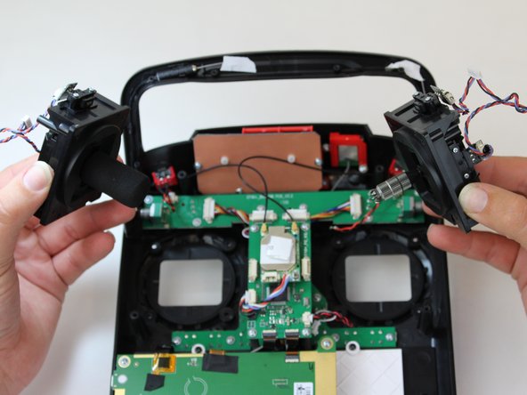

  10. Yuneec ST10 Plus Joystick Replacement: crwdns2935265:010crwdnd2935265:01crwdnd2935265:03crwdne2935265:0 Yuneec ST10 Plus Joystick Replacement: crwdns2935265:010crwdnd2935265:02crwdnd2935265:03crwdne2935265:0 Yuneec ST10 Plus Joystick Replacement: crwdns2935265:010crwdnd2935265:03crwdnd2935265:03crwdne2935265:0
    • Flip the controller back over.
    • Remove the joysticks.
