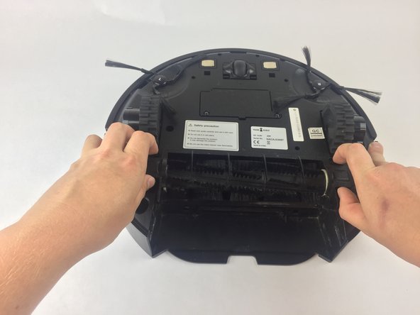

    • Flip over the device to access the brush cover.
    • To remove the brush cover, push together the two snap releases on the right and left sides of the cover until it releases.
    • Do not push the release snaps too close together. Doing so may cause them to break and the brush could fall out when in use.

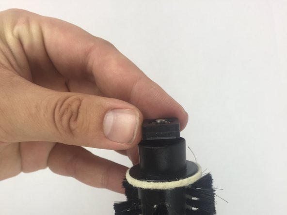

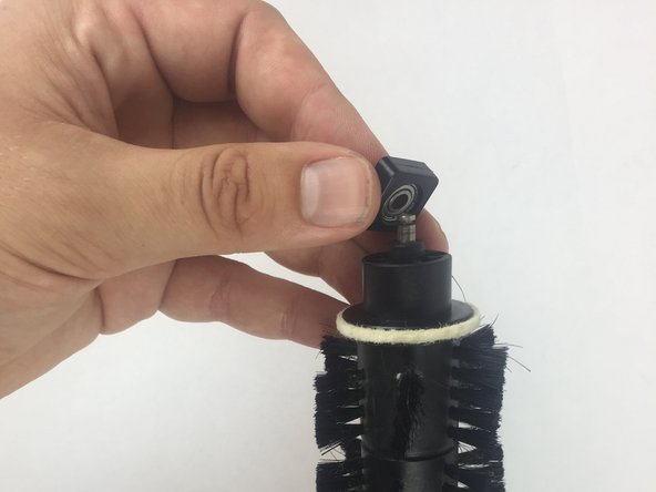

    • When preparing a new brush, it is very important to make sure that the new one is equipped with the proper end-pieces.
    • Take the round metal piece and slide it into the square rubber coating. Then, stick it on the end with the metal peg.
