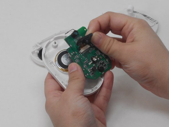

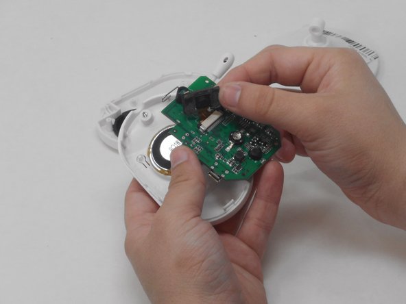

    3. Yoton YB02 Motion Sensor Replacement: crwdns2935265:03crwdnd2935265:01crwdnd2935265:03crwdne2935265:0 Yoton YB02 Motion Sensor Replacement: crwdns2935265:03crwdnd2935265:02crwdnd2935265:03crwdne2935265:0 Yoton YB02 Motion Sensor Replacement: crwdns2935265:03crwdnd2935265:03crwdnd2935265:03crwdne2935265:0
      • With the soldering iron, desolder the pins holding the camera in place onto the motherboard on the other side of the motherboard.
      • Carefully pry off the camera unit, including the motion sensor, with your hands.
