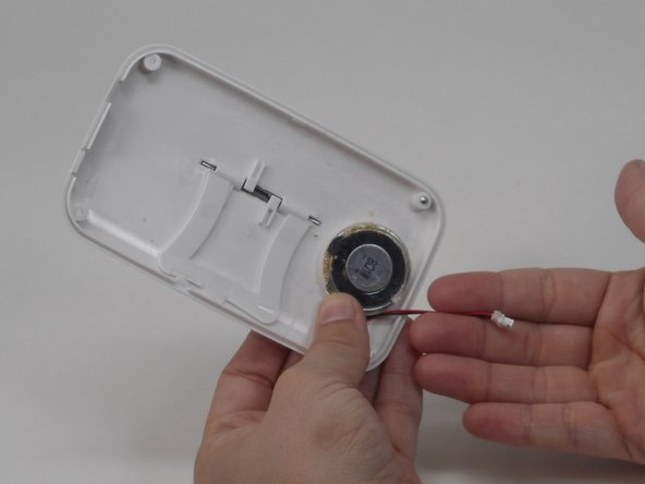

    • Use a Phillips #0 screwdriver to remove the four 7 mm screws from the back panel of the monitor.
  2. Yoton YB02 Monitor Speaker Replacement: crwdns2935265:02crwdnd2935265:01crwdnd2935265:02crwdne2935265:0 Yoton YB02 Monitor Speaker Replacement: crwdns2935265:02crwdnd2935265:02crwdnd2935265:02crwdne2935265:0
    • Use a plastic opening tool to separate the back panel from the monitor.
    • It is recommended to start from a corner, and run the tool along the edge of the panel.
  3. Yoton YB02 Monitor Speaker Replacement: crwdns2935265:03crwdnd2935265:01crwdnd2935265:02crwdne2935265:0 Yoton YB02 Monitor Speaker Replacement: crwdns2935265:03crwdnd2935265:02crwdnd2935265:02crwdne2935265:0
    • Using the plastic tool, disconnect the cables connecting the speaker to the motherboard.

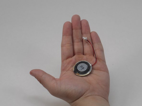

  4. Yoton YB02 Monitor Speaker Replacement: crwdns2935265:04crwdnd2935265:01crwdnd2935265:02crwdne2935265:0 Yoton YB02 Monitor Speaker Replacement: crwdns2935265:04crwdnd2935265:02crwdnd2935265:02crwdne2935265:0
    • Using the metal spudger, pry off the speaker from the back panel.
    • It is recommended to scrape off excess glue holding the speaker to the panel with the spudger.
