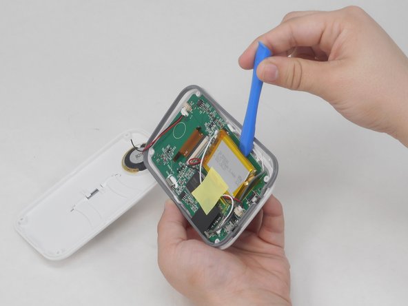

    • Use a Phillips #0 screwdriver to remove the four 7 mm screws from the back panel of the monitor.
  2. Yoton YB02 Monitor Battery Replacement: crwdns2935265:02crwdnd2935265:01crwdnd2935265:02crwdne2935265:0 Yoton YB02 Monitor Battery Replacement: crwdns2935265:02crwdnd2935265:02crwdnd2935265:02crwdne2935265:0
    • Use a plastic opening tool to separate the back panel from the monitor.
    • It is recommended to start from a corner, and run the tool along the edge of the panel.
  3. Yoton YB02 Monitor Battery Replacement: crwdns2935265:03crwdnd2935265:01crwdnd2935265:02crwdne2935265:0 Yoton YB02 Monitor Battery Replacement: crwdns2935265:03crwdnd2935265:02crwdnd2935265:02crwdne2935265:0

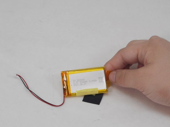

    • With the plastic tool, pry off the monitor battery from the motherboard.
  4. Yoton YB02 Monitor Battery Replacement: crwdns2935265:04crwdnd2935265:01crwdnd2935265:03crwdne2935265:0 Yoton YB02 Monitor Battery Replacement: crwdns2935265:04crwdnd2935265:02crwdnd2935265:03crwdne2935265:0 Yoton YB02 Monitor Battery Replacement: crwdns2935265:04crwdnd2935265:03crwdnd2935265:03crwdne2935265:0

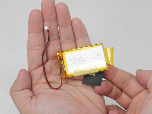

    • Using the plastic tool, disconnect the cables connecting the battery to the motherboard.
