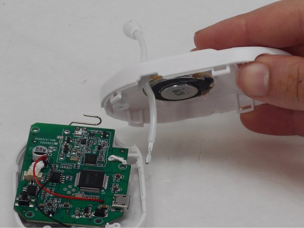

    • Use a Phillips #0 screwdriver to remove the single 7 mm screw from the back of the panel from the camera.
  2. Yoton YB02 Microphone Replacement: crwdns2935265:02crwdnd2935265:01crwdnd2935265:01crwdne2935265:0
    • Use a metal spudger to pry off the back panel from the camera.
    • It is recommended to pry at the edges of the panel and run through the edge of the panel.

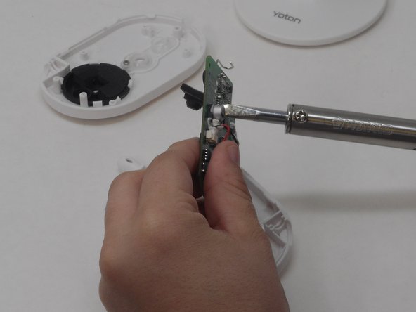

    • With the soldering iron, desolder the pin holding the microphone in place on the motherboard.

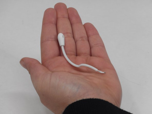

    • Carefully slide the microphone and microphone cable through the back panel.
