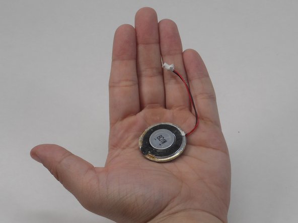

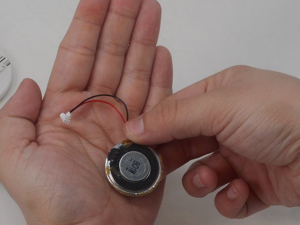

  4. Yoton YB02 Camera Stand Speaker Replacement: crwdns2935265:04crwdnd2935265:01crwdnd2935265:01crwdne2935265:0
    • Use a plastic opening tool to remove the camera speaker from the panel.
    • It is recommended to remove or scrape off the excess glue holding the camera in place.
  5. Yoton YB02 Camera Stand Speaker Replacement: crwdns2935265:05crwdnd2935265:01crwdnd2935265:03crwdne2935265:0 Yoton YB02 Camera Stand Speaker Replacement: crwdns2935265:05crwdnd2935265:02crwdnd2935265:03crwdne2935265:0 Yoton YB02 Camera Stand Speaker Replacement: crwdns2935265:05crwdnd2935265:03crwdnd2935265:03crwdne2935265:0
    • With the plastic opening tool, detach the cable from the speaker to the motherboard at the clips.
