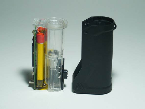

  2. Yocan UNI Pro Disassembly, Housing Removal: crwdns2935265:02crwdnd2935265:01crwdnd2935265:03crwdne2935265:0 Yocan UNI Pro Disassembly, Housing Removal: crwdns2935265:02crwdnd2935265:02crwdnd2935265:03crwdne2935265:0 Yocan UNI Pro Disassembly, Housing Removal: crwdns2935265:02crwdnd2935265:03crwdnd2935265:03crwdne2935265:0
    • Flip the device over and pull the cover upwards

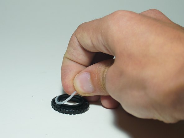

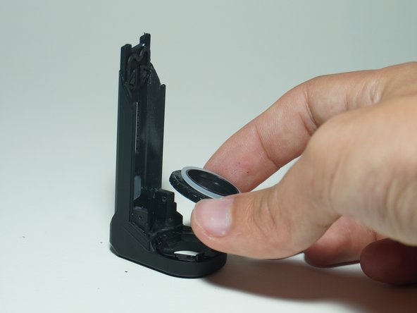

  4. Yocan UNI Pro Disassembly, O-Ring: crwdns2935265:04crwdnd2935265:01crwdnd2935265:02crwdne2935265:0 Yocan UNI Pro Disassembly, O-Ring: crwdns2935265:04crwdnd2935265:02crwdnd2935265:02crwdne2935265:0
    • Remove O-Ring

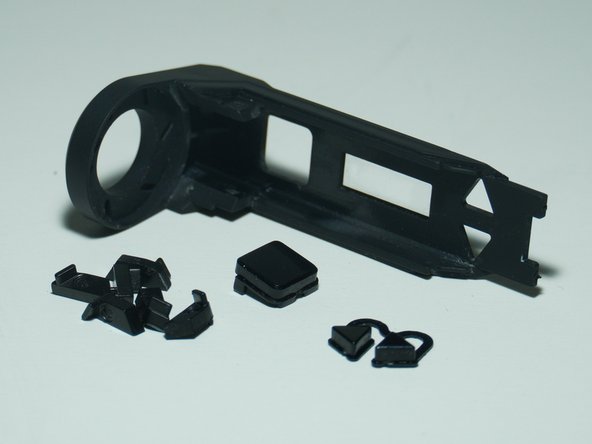

  5. Yocan UNI Pro Disassembly, Buttons and Shutter Pieces: crwdns2935265:05crwdnd2935265:01crwdnd2935265:02crwdne2935265:0 Yocan UNI Pro Disassembly, Buttons and Shutter Pieces: crwdns2935265:05crwdnd2935265:02crwdnd2935265:02crwdne2935265:0
    • Remove buttons and aperture/shutter pieces
    • They should just fall out. If not, they can be removed with your fingers

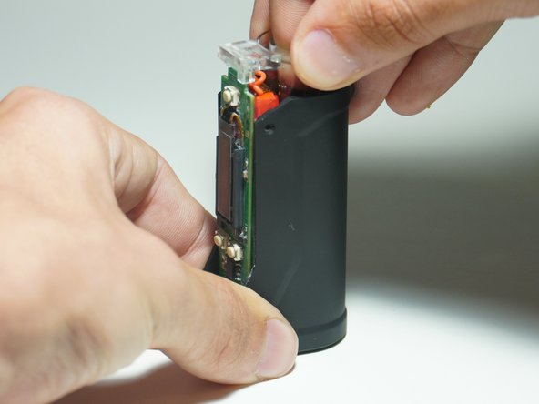

  6. Yocan UNI Pro Disassembly, Inner Plasic: crwdns2935265:06crwdnd2935265:01crwdnd2935265:02crwdne2935265:0 Yocan UNI Pro Disassembly, Inner Plasic: crwdns2935265:06crwdnd2935265:02crwdnd2935265:02crwdne2935265:0
    • Grip the bottom and top of the device and pull up slightly
    • The next step will fully remove it

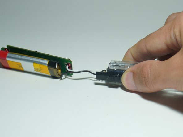

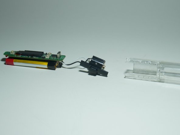

  7. Yocan UNI Pro Disassembly, Full Electronics Removal: crwdns2935265:07crwdnd2935265:01crwdnd2935265:03crwdne2935265:0 Yocan UNI Pro Disassembly, Full Electronics Removal: crwdns2935265:07crwdnd2935265:02crwdnd2935265:03crwdne2935265:0 Yocan UNI Pro Disassembly, Full Electronics Removal: crwdns2935265:07crwdnd2935265:03crwdnd2935265:03crwdne2935265:0

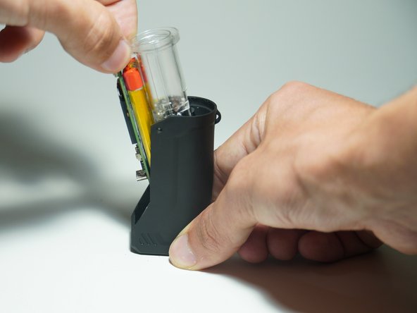

    • Pull the clear plastic out and away to the left
    • Pull up at an angle

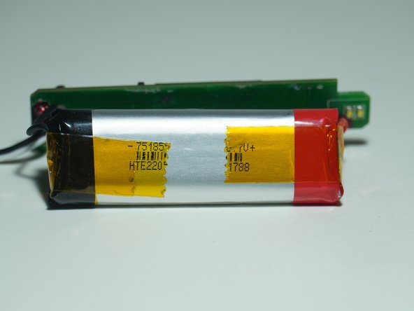

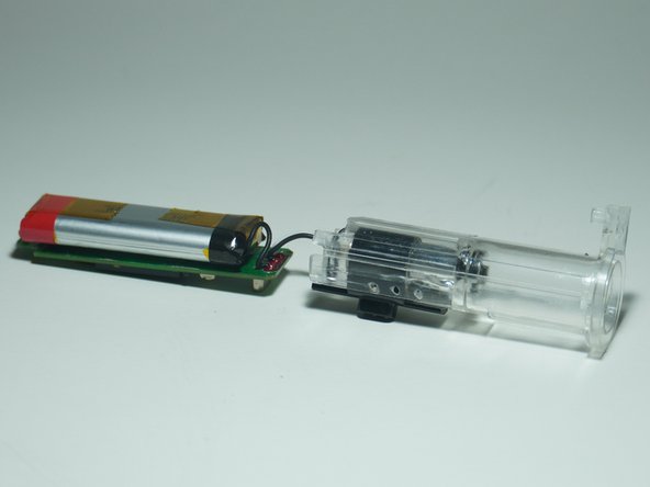

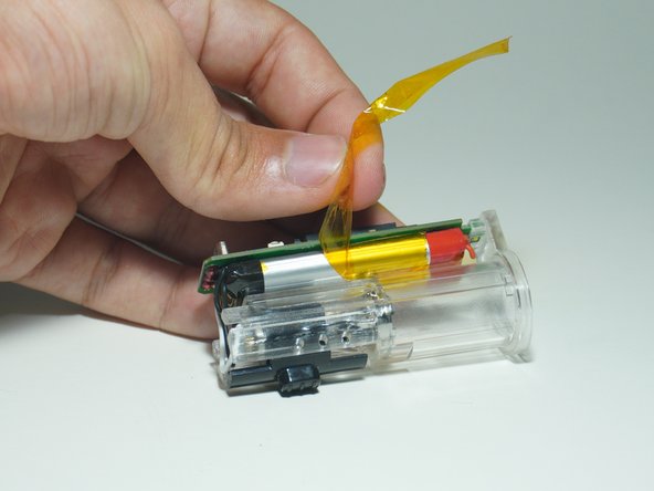

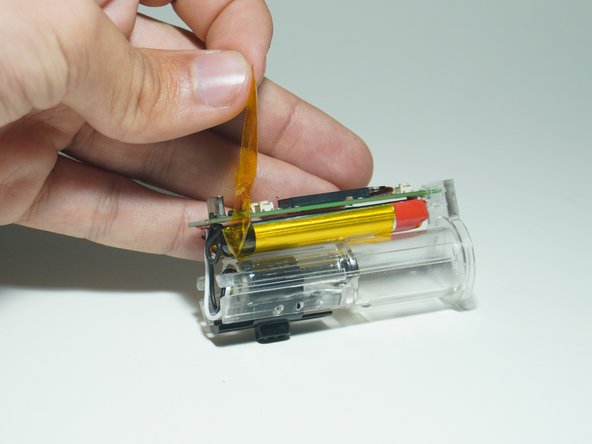

  8. Yocan UNI Pro Disassembly, Kapton Tape Removal: crwdns2935265:08crwdnd2935265:01crwdnd2935265:03crwdne2935265:0 Yocan UNI Pro Disassembly, Kapton Tape Removal: crwdns2935265:08crwdnd2935265:02crwdnd2935265:03crwdne2935265:0 Yocan UNI Pro Disassembly, Kapton Tape Removal: crwdns2935265:08crwdnd2935265:03crwdnd2935265:03crwdne2935265:0
    • Peel the Kapton Tape off of the battery and clear plastic

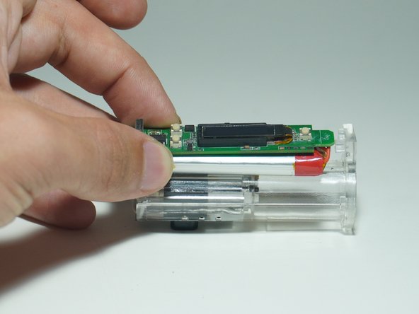

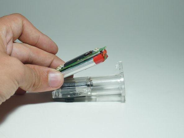

  9. Yocan UNI Pro Disassembly, PCB Slide Out: crwdns2935265:09crwdnd2935265:01crwdnd2935265:02crwdne2935265:0 Yocan UNI Pro Disassembly, PCB Slide Out: crwdns2935265:09crwdnd2935265:02crwdnd2935265:02crwdne2935265:0
    • Slide the circuit board back so that it is not under the plastic lip
  10. Yocan UNI Pro Disassembly, Battery Adhesive Removal: crwdns2935265:010crwdnd2935265:01crwdnd2935265:03crwdne2935265:0 Yocan UNI Pro Disassembly, Battery Adhesive Removal: crwdns2935265:010crwdnd2935265:02crwdnd2935265:03crwdne2935265:0 Yocan UNI Pro Disassembly, Battery Adhesive Removal: crwdns2935265:010crwdnd2935265:03crwdnd2935265:03crwdne2935265:0
    • Slowly peel the battery and circuit board away from the plastic housing
    • There is some adhesive under the battery so be careful

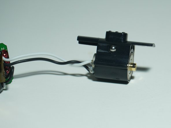

  11. Yocan UNI Pro Disassembly, Height Adjustment Module: crwdns2935265:011crwdnd2935265:01crwdnd2935265:03crwdne2935265:0 Yocan UNI Pro Disassembly, Height Adjustment Module: crwdns2935265:011crwdnd2935265:02crwdnd2935265:03crwdne2935265:0 Yocan UNI Pro Disassembly, Height Adjustment Module: crwdns2935265:011crwdnd2935265:03crwdnd2935265:03crwdne2935265:0
    • Grip the plastic case and use your thumb to remove the height adjustment module
    • It should slide out all the way

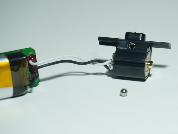

    • The ball bearings in the next step might fall out right away so be careful that they don't roll away!
  12. Yocan UNI Pro Disassembly, Ball Bearings: crwdns2935265:012crwdnd2935265:01crwdnd2935265:03crwdne2935265:0 Yocan UNI Pro Disassembly, Ball Bearings: crwdns2935265:012crwdnd2935265:02crwdnd2935265:03crwdne2935265:0 Yocan UNI Pro Disassembly, Ball Bearings: crwdns2935265:012crwdnd2935265:03crwdnd2935265:03crwdne2935265:0
    • There are two ball bearings that make the height adjustment module work and lock into position.
    • There is one on each side and they easily fall out so be careful

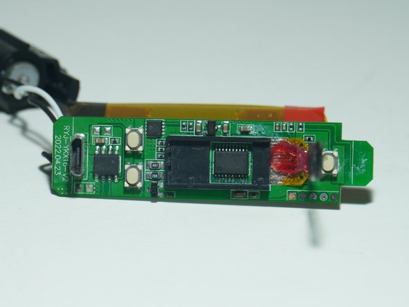

  13. Yocan UNI Pro Disassembly, Motherboard and Battery Closeup: crwdns2935265:013crwdnd2935265:01crwdnd2935265:02crwdne2935265:0 Yocan UNI Pro Disassembly, Motherboard and Battery Closeup: crwdns2935265:013crwdnd2935265:02crwdnd2935265:02crwdne2935265:0
    • Just some pretty pictures

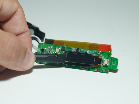

  14. Yocan UNI Pro Disassembly, Screen Removal: crwdns2935265:014crwdnd2935265:01crwdnd2935265:03crwdne2935265:0 Yocan UNI Pro Disassembly, Screen Removal: crwdns2935265:014crwdnd2935265:02crwdnd2935265:03crwdne2935265:0 Yocan UNI Pro Disassembly, Screen Removal: crwdns2935265:014crwdnd2935265:03crwdnd2935265:03crwdne2935265:0
    • Use a spudger to carefully remove the screen
    • It is held down with adhesive
    • There is no way to remove the screen completely unless you get rid of the red strain relief material and desolder it from the board

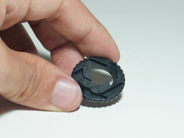

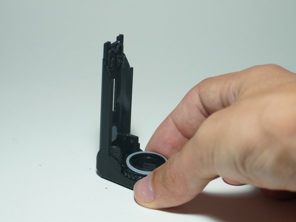

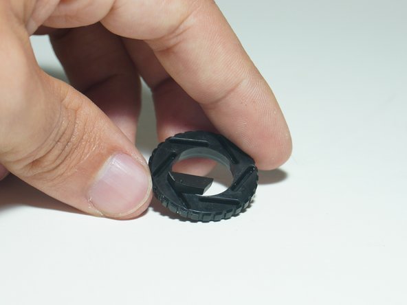

  15. Yocan UNI Pro Disassembly, Shutter Reassembly: crwdns2935265:015crwdnd2935265:01crwdnd2935265:03crwdne2935265:0 Yocan UNI Pro Disassembly, Shutter Reassembly: crwdns2935265:015crwdnd2935265:02crwdnd2935265:03crwdne2935265:0 Yocan UNI Pro Disassembly, Shutter Reassembly: crwdns2935265:015crwdnd2935265:03crwdnd2935265:03crwdne2935265:0
    • For reassembly, place the slots on the small shutter pieces into the circular holder
