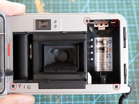

  3. Yashica T5D Shutter Flex Cable Replacement: crwdns2935265:03crwdnd2935265:01crwdnd2935265:03crwdne2935265:0 Yashica T5D Shutter Flex Cable Replacement: crwdns2935265:03crwdnd2935265:02crwdnd2935265:03crwdne2935265:0 Yashica T5D Shutter Flex Cable Replacement: crwdns2935265:03crwdnd2935265:03crwdnd2935265:03crwdne2935265:0

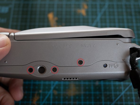

    • Unscrew the three screws inside the battery compartment.
    • Open the film compartment and unscrew the five screws, noting that one marked with an "H" is hidden under a spring clip. The screws are of different lengths and need to be labeled for reference when reinstalling them.
    • Unscrew the three screws at the bottom.

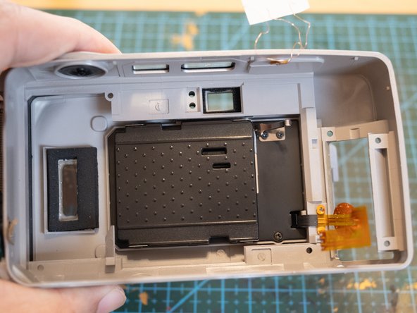

  4. Yashica T5D Shutter Flex Cable Replacement: crwdns2935265:04crwdnd2935265:01crwdnd2935265:01crwdne2935265:0
    • There are several clips on the front cover that can be gently pried open using a plastic pry bar along the crevices. Slowly slide open the front cover.
    • There is a line of waterproof rubber around the edge of the front cover, and wires are also present. When using tools, do not insert too deeply. (Please refer iPod disassembly for more information)
  5. Yashica T5D Shutter Flex Cable Replacement: crwdns2935265:05crwdnd2935265:01crwdnd2935265:01crwdne2935265:0

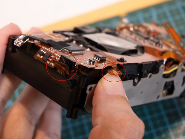

    • Unsolder the four wires marked with No.1 yellow marker.
    • Unsolder the four wires marked with No.2 marker.
    • Unsolder the date cable with three contacts marked with No.3 marker.
    • Unsolder the lens cable with three contacts marked with No.4 marker.
    • Unsolder the button cable with three contacts (this machine may have been repaired in the past and used flying wires) marked with No.5 marker.

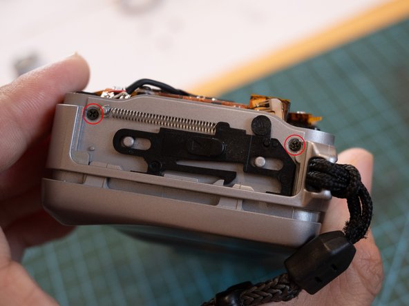

  6. Yashica T5D Shutter Flex Cable Replacement: crwdns2935265:06crwdnd2935265:01crwdnd2935265:02crwdne2935265:0 Yashica T5D Shutter Flex Cable Replacement: crwdns2935265:06crwdnd2935265:02crwdnd2935265:02crwdne2935265:0
    • Pull outwards to remove the left cover plate.
    • Unscrew 2 screws.

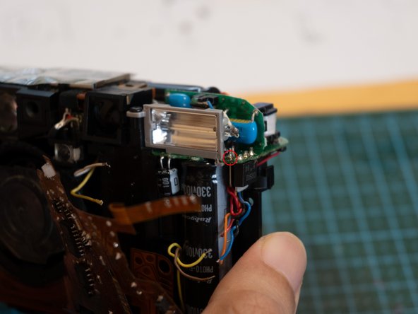

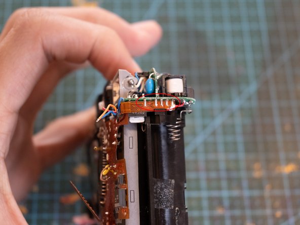

  7. Yashica T5D Shutter Flex Cable Replacement: crwdns2935265:07crwdnd2935265:01crwdnd2935265:02crwdne2935265:0 Yashica T5D Shutter Flex Cable Replacement: crwdns2935265:07crwdnd2935265:02crwdnd2935265:02crwdne2935265:0
    • Gently lift the internal part from the right side. Be careful not to break the upper function cable (normal machines have soft cable, unlike mine) and date cable (date cable should bent and placed in the gap between the capacitor).

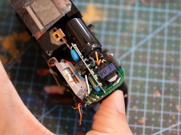

  8. Yashica T5D Shutter Flex Cable Replacement: crwdns2935265:08crwdnd2935265:01crwdnd2935265:02crwdne2935265:0 Yashica T5D Shutter Flex Cable Replacement: crwdns2935265:08crwdnd2935265:02crwdnd2935265:02crwdne2935265:0
    • Unscrew the 2 screws under the red circle, which are the two rows of wires used to connect the lens and the main board.
    • Unsolder the 5 contacts that connect to the flash unit.

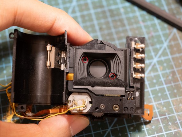

  13. Yashica T5D Shutter Flex Cable Replacement: crwdns2935265:013crwdnd2935265:01crwdnd2935265:03crwdne2935265:0 Yashica T5D Shutter Flex Cable Replacement: crwdns2935265:013crwdnd2935265:02crwdnd2935265:03crwdne2935265:0 Yashica T5D Shutter Flex Cable Replacement: crwdns2935265:013crwdnd2935265:03crwdnd2935265:03crwdne2935265:0
    • Unscrew the 6 screws, paying attention to the 2 screws on the side.
    • Take off the lens module.

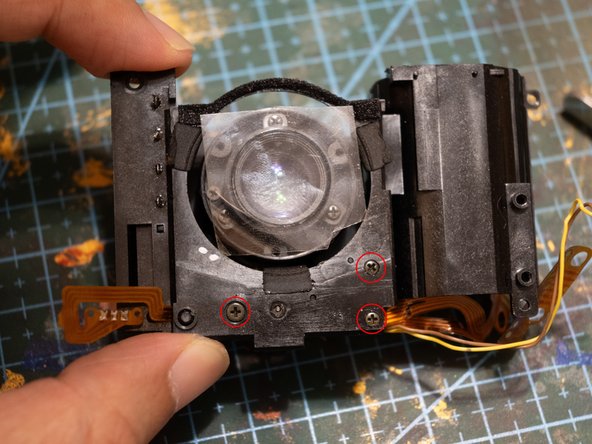

    • Pic2: Unscrew the 2 screws, gently peel off the adhesive on the upper left corner, and remove the light shield.
    • Pic3: Unscrew 3 screws to take off the lens and shutter module.

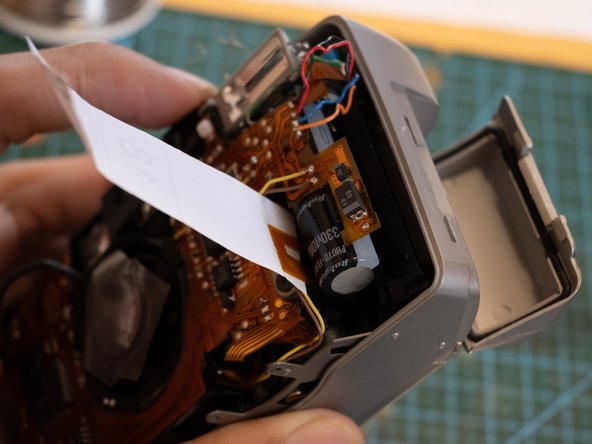

  16. Yashica T5D Shutter Flex Cable Replacement: crwdns2935265:016crwdnd2935265:01crwdnd2935265:02crwdne2935265:0 Yashica T5D Shutter Flex Cable Replacement: crwdns2935265:016crwdnd2935265:02crwdnd2935265:02crwdne2935265:0
    • When reassemble, follow the disassembly sequence (it is recommended to record a video to review and find any missed information such as how to place wire).
    • For the date cable on the D version, you can use a strip of paper with adhesive on one end to pull it back.
