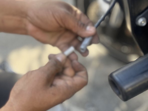

    • Use your motorcycle's key to open the rear seat, and remove the seat to access the tool pouch.

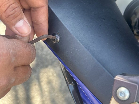

    • Use a 10 mm Allen key to remove the front seat and expose the battery.

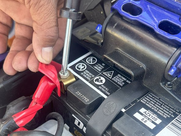

    • Using a Phillips-head screwdriver, remove the screws attached to the battery terminals.

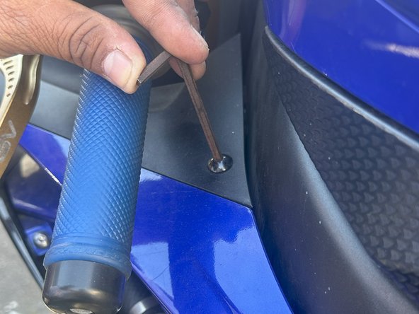

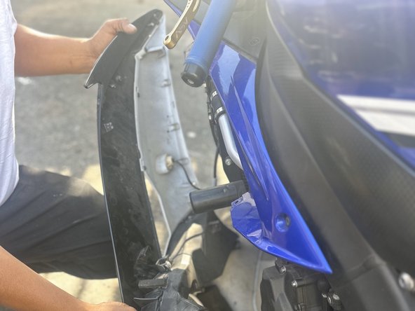

    • Using the 10mm Allen key, remove the hardware securing the left side fairings.
  5. Yamaha YZF-R6 Fan Relay Replacement: crwdns2935265:05crwdnd2935265:01crwdnd2935265:03crwdne2935265:0 Yamaha YZF-R6 Fan Relay Replacement: crwdns2935265:05crwdnd2935265:02crwdnd2935265:03crwdne2935265:0 Yamaha YZF-R6 Fan Relay Replacement: crwdns2935265:05crwdnd2935265:03crwdnd2935265:03crwdne2935265:0

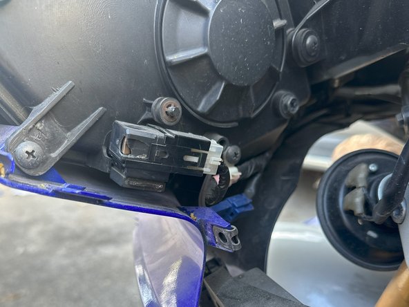

    • Remove the middle fairing on the left-hand side, and carefully unclip the turn signal cable.
  6. Yamaha YZF-R6 Fan Relay Replacement: crwdns2935265:06crwdnd2935265:01crwdnd2935265:03crwdne2935265:0 Yamaha YZF-R6 Fan Relay Replacement: crwdns2935265:06crwdnd2935265:02crwdnd2935265:03crwdne2935265:0 Yamaha YZF-R6 Fan Relay Replacement: crwdns2935265:06crwdnd2935265:03crwdnd2935265:03crwdne2935265:0

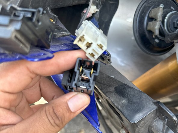

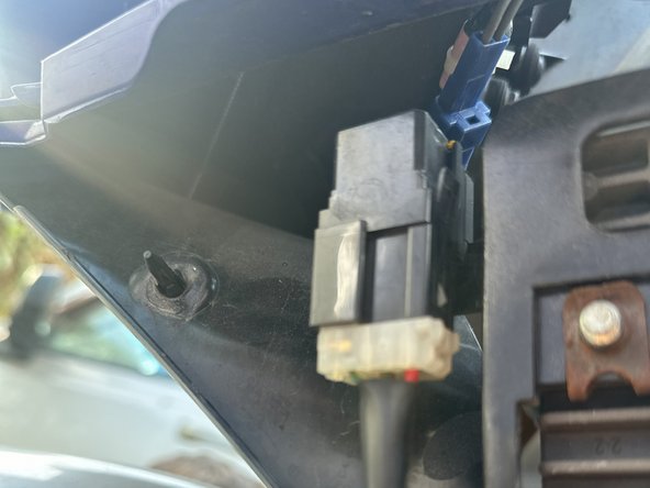

    • Once you have removed the left-hand cover under the clutch lever, locate the relay assemblies for the lights and cooling fans.
  7. Yamaha YZF-R6 Fan Relay Replacement: crwdns2935265:07crwdnd2935265:01crwdnd2935265:02crwdne2935265:0 Yamaha YZF-R6 Fan Relay Replacement: crwdns2935265:07crwdnd2935265:02crwdnd2935265:02crwdne2935265:0
    • Use a flat-head screwdriver to gently pry the locking mechanism open on the relay assembly. You can remove the relay by itself or with the bracket assembly.
