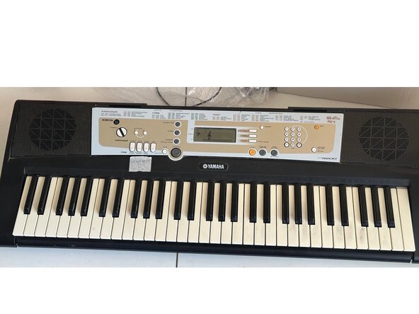

Yamaha PSR-R200 Rubbers and Operational amplifier Replacement
  1. Yamaha PSR-R200 Rubbers and Operational amplifier Replacement, Open the case: crwdns2935265:01crwdnd2935265:01crwdnd2935265:02crwdne2935265:0 Yamaha PSR-R200 Rubbers and Operational amplifier Replacement, Open the case: crwdns2935265:01crwdnd2935265:02crwdnd2935265:02crwdne2935265:0

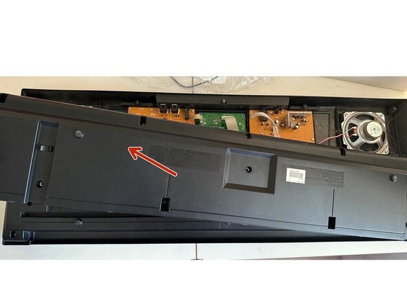

    • Unscrew the back screws
  2. Yamaha PSR-R200 Rubbers and Operational amplifier Replacement, Open the case II: crwdns2935265:02crwdnd2935265:01crwdnd2935265:03crwdne2935265:0 Yamaha PSR-R200 Rubbers and Operational amplifier Replacement, Open the case II: crwdns2935265:02crwdnd2935265:02crwdnd2935265:03crwdne2935265:0 Yamaha PSR-R200 Rubbers and Operational amplifier Replacement, Open the case II: crwdns2935265:02crwdnd2935265:03crwdnd2935265:03crwdne2935265:0
    • Now pull out the case half that covers PCB section
    • Unscrew the central screw (showed with red circle) and pull out the keyboard. Disconnect blue socket by PUSHING INSIDE on the sliding part of it, not pulling it up.
    • Another LCD (green) board sockets should be pulled up to release the wires.
