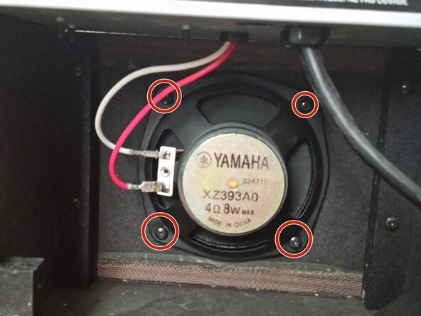

    • Turn the amp around until you can see 2 screws on the back-bottom of the amp.
    • Using the Phillips #0 screwdriver, remove the two screws found at the back-bottom of the amp.
  2. Yamaha GA-10 Speaker Replacement: crwdns2935265:02crwdnd2935265:01crwdnd2935265:02crwdne2935265:0 Yamaha GA-10 Speaker Replacement: crwdns2935265:02crwdnd2935265:02crwdnd2935265:02crwdne2935265:0
    • Remove the plate found at the back-bottom that you removed the screws from.
    • The speaker should no longer be obstructed.
    • Remove the four screws on the corners of the speaker that are holding it in place.
  3. Yamaha GA-10 Speaker Replacement: crwdns2935265:03crwdnd2935265:01crwdnd2935265:01crwdne2935265:0
    • Remove the speaker from the amp in order to more clearly see the 2 wires connecting it.
  4. Yamaha GA-10 Speaker Replacement: crwdns2935265:04crwdnd2935265:01crwdnd2935265:01crwdne2935265:0
    • You may now gently pull the wires out of the speaker one at a time, until both are removed.
