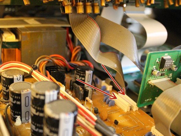

  5. Yamaha DM1000 Faders Replacement, Remove 4 cables before opening: crwdns2935265:05crwdnd2935265:01crwdnd2935265:02crwdne2935265:0 Yamaha DM1000 Faders Replacement, Remove 4 cables before opening: crwdns2935265:05crwdnd2935265:02crwdnd2935265:02crwdne2935265:0
    • remove carrefully from the side the 2 withe connectors.
    • remove carrefully 2 cables from the power unit, unlock first the connector.

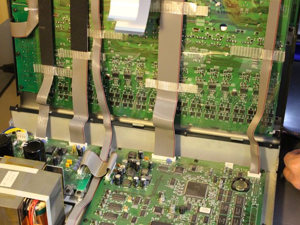

  6. Yamaha DM1000 Faders Replacement, Opening the  console: crwdns2935265:06crwdnd2935265:01crwdnd2935265:03crwdne2935265:0 Yamaha DM1000 Faders Replacement, Opening the  console: crwdns2935265:06crwdnd2935265:02crwdnd2935265:03crwdne2935265:0 Yamaha DM1000 Faders Replacement, Opening the  console: crwdns2935265:06crwdnd2935265:03crwdnd2935265:03crwdne2935265:0
    • open carefully the console from back to front by graping the sides.
    • open connectors and remove 5 cables.
    • you can now remove the upper part of the console.

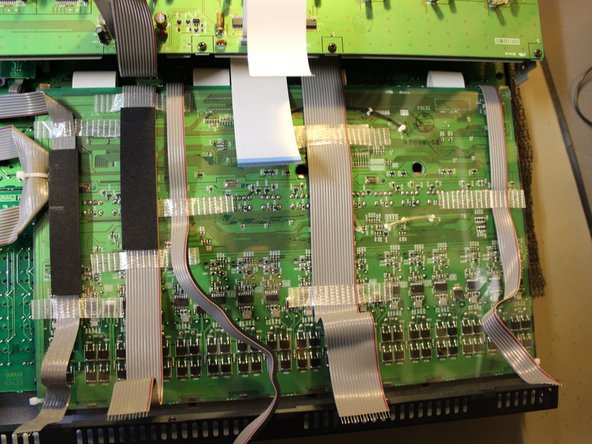

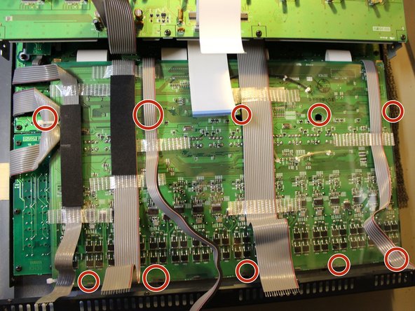

  7. Yamaha DM1000 Faders Replacement, Removing the circuit board: crwdns2935265:07crwdnd2935265:01crwdnd2935265:03crwdne2935265:0 Yamaha DM1000 Faders Replacement, Removing the circuit board: crwdns2935265:07crwdnd2935265:02crwdnd2935265:03crwdne2935265:0 Yamaha DM1000 Faders Replacement, Removing the circuit board: crwdns2935265:07crwdnd2935265:03crwdnd2935265:03crwdne2935265:0

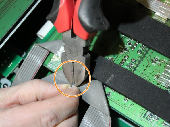

    • Cut the plastic clamps. Their are 4 clamps in the corners and 1 clamp holding flat cable in place.
    • Unscrew the 10 screws with a Phillips #2 screwdriver.
